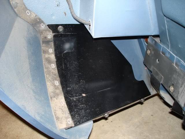

I found a pair of splash shields in my parts car, and was trying to put them on my car, but not sure how they go. These shields are mounted in front of the front tires and it gets the rubber "?" mark gasket that runs up behind the head lights. If you could give me a pic of how they mount and to make sure I am not missing any hardware, I would be greatly appreciative. Thanks For-B-Bodies for all the help.
Thanks for the pic. Where does it mount at on the bottom closest to the tire? Also, does the passenger look different, because mine are identical to the pic above? If they are different, is there any where I can purchase the one for the passenger side? Thanks for the pic.
Same piece is used on both sides, just flipped over. Seals the front valance lower reinforcement panel, black panel pictured above to the inside of the front fender. Runs up to the top of the fender. If the panel is not missing, it should be pretty evident, small holes for the clips correspond to the holes in the shield. If you need replacements, I would recommend Jim at Detroit Muscle Technologies.

Thanks alot. That helps a bunch. Yeah I ordered most of my splash shields from DMT.

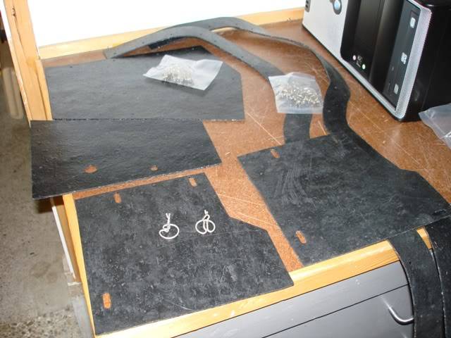

I need the panels for my project. Any idea if they are available or after market?? Pops
I have the rubber kit from them,I need the tin shields that the rubber fastens to. POPS
