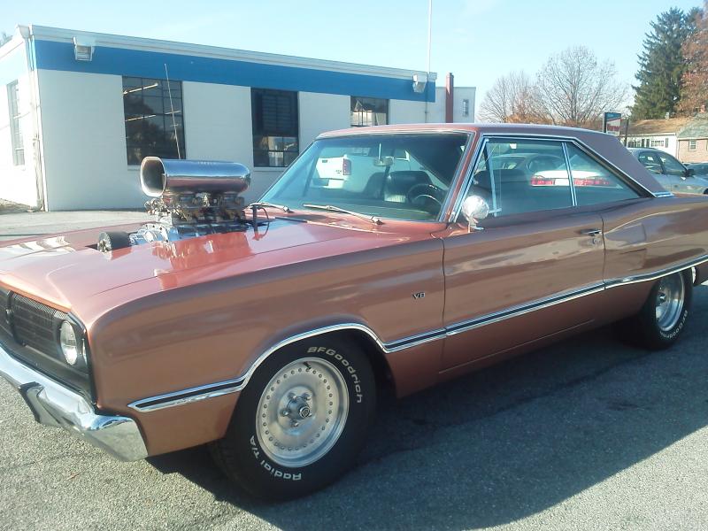

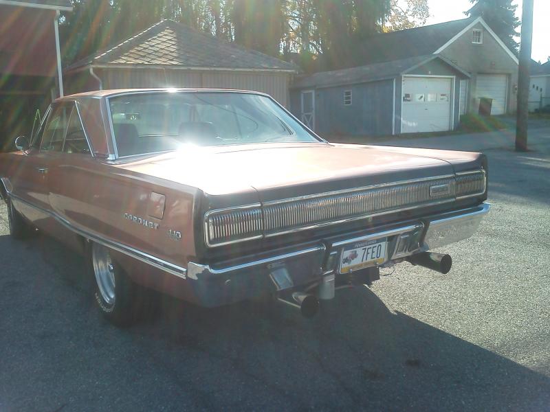

sweet lookin car! i can see where you got your username.

Welcome aboard. Very nice Coronet. Don't let the English teacher discourage you. Some people are just too ****.
