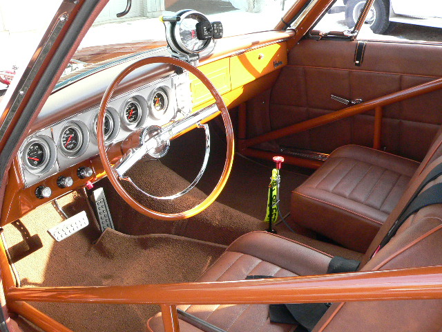

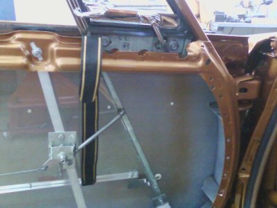

Do you want the windows to go up and down? Either way I'd remove the regulator itself. No movement, just clamp the track to hold them up. Otherwise add a strap and a couple snaps. You can see the second snap near the vertical roll bar tube above the lower seat cushion.
