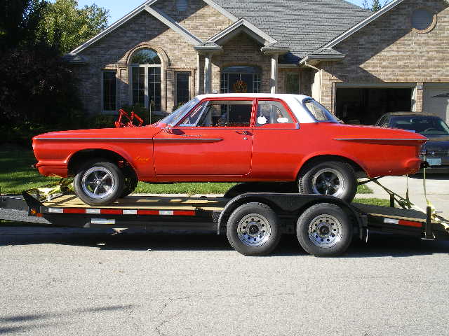

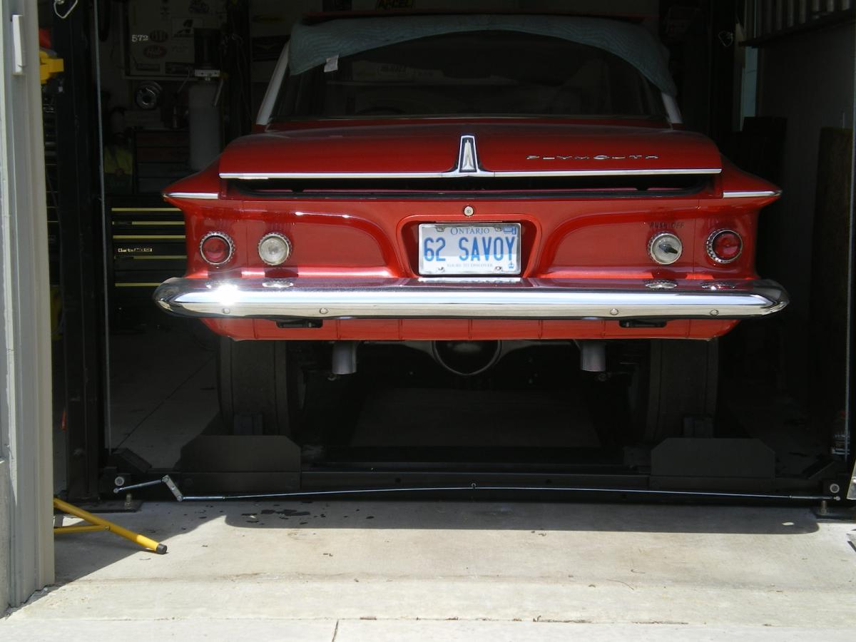

This is how my 63 sits with the Mancini 3400 lb springs. I bought the set and it sits and handles great on these springs. Hooks up good at the track also. Ron
