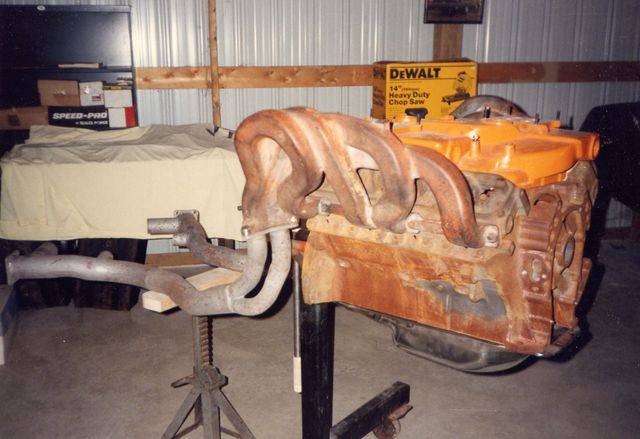

nice parts but,,the intake shown is not a stage 3 unit..if it was all the carb holes would be the same size(larger). and the plenum to runner transition would be smooth..not a drop off like on yours.thats a stage 1 413-426 unit..fyi.
Oh, I was told it was the matching one when I bought them.
Agree that is the same intake on my 63 savoy. Stage 1. Nice parts thou
It has a casting date of 12-15-62 so it's most likely a 63 intake...

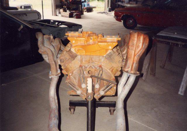

Those are not tri-Y manifolds, either. The pics make that obvious, but if you sold/advertised those manifolds without pics you're likely to get into a little trouble.
These are tri-Y manifolds:
@krazykuda ...I suggest you do some more research on these parts you are offering, and then confirm here to potential buyers what they actually are.
We are not going to referee in a future sale where parts are misrepresented.
