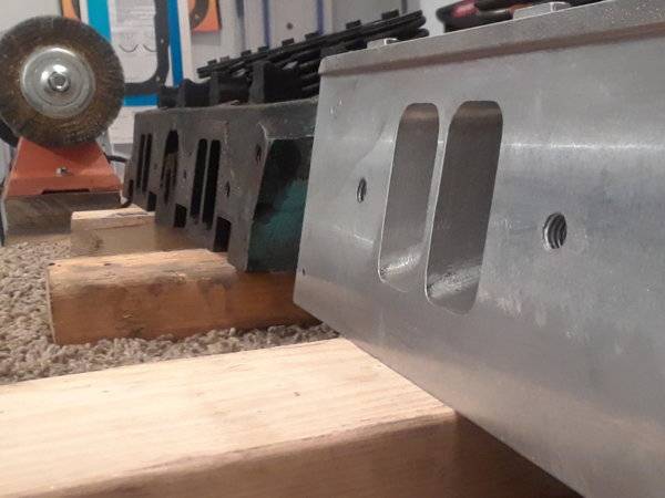

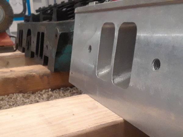

I see that the Stage VI HEADS have a raised intake port, to get a better angle of flow to the valve . So if i put these on a low deck block, then I would need a raised deck intake? Right? So can I use a low deck intake on a 383 low deck block, by using the spacer plates? And using the Stage VI Heads? Or do I need to get a 440 intake to use on a low deck block with these heads? Then of course I wouldn't need any spacer plates. So many choices and options here, it seems. I'll try to include some pics of these heads next to some iron 906 heads, so you can see what im talking about. 20180111_155752.jpg

I'm asking this because I have a tunnel ram for my 496 low deck (383 block), and I'm thinking about putting these Stage VI heads on it, at some point. All l have is a low deck Weiand Hi Ram right now. The heads I have on the motor now are Stealths, so they will work with the low deck Hi Ram. I guess the raised deck Weiand is still available. May have to buy one of those, if I put on the Stage VI HEADS.
you'll need a RB intake or the intakes spacers to use a low deck intake.
OK great! That's what I was wondering. I have a low deck motor, low deck intake, and spacers. So I have what I need. Thank You!

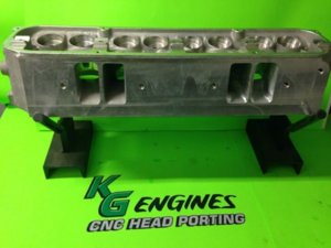

His heads, pictured are standard port window, raised port. Mopar also offered a non-raised port "street" Stage VI and several Max Wedge port window, raised port heads with different combustion chamber configurations/rocker setups.
Stage VI Max Wedge head:
