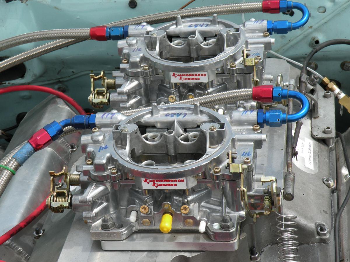

its in your air mixture screws in front of the carb. turn them all the way in and back them out 2 turns. then start car and turn out and get it where your idle starts to peak out, you may have to go in or out but you want max rpm through your air mixture screws.
i had to do the same on my race car yesterday when i swapped out my carbs, mine would also die in gear. my guess is yours are turned in too far. keep me posted.

mixture balance screws...
A rule of thumb when performing this procedure is to always make your last adjustment turning the screw IN..... This preloads the tention spring and will prevent the screw from turning out on it's own.
