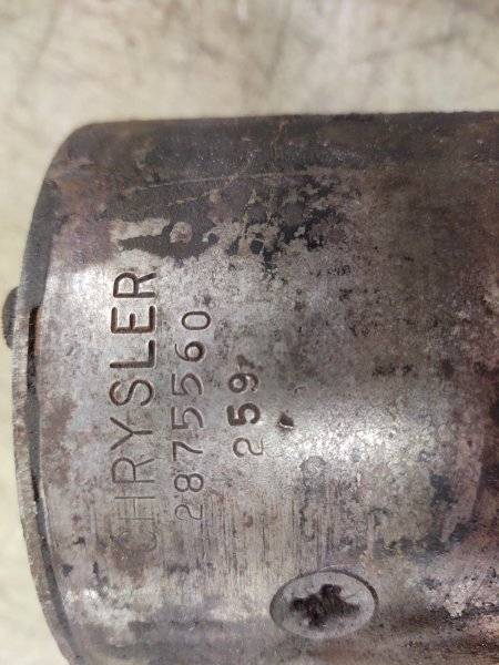

This example I snagged from a 69 valiant 4-door 273 engine. It's a little early for my 70 Bee ( 9/17/69 ) SPD....but I don't care gonna use it anyway
