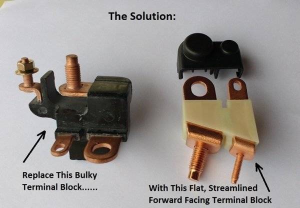

Also used the terminal relocation kit sold by a member here, can't remember the name but made install a breeze with plenty of clearance.
