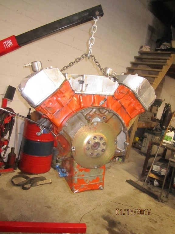

Better to buy a new flywheel that works with the bell housing and starter. Moepar you should post the part number of bell housing and picture wouldn't hurt. Do you have a trans that fits the hole for bearing retainer.
Went to Brewer Performance website they list 172 and 130 tooth 8 bolt flywheels. The 143 tooth is 6 bolt to the best of MY limited knowledge.
IMO you have a 172 tooth wheel if that's what you have it's worth some good money in good condition.
The 130 tooth is a 10.5 inch. Easier to find parts for IMO.
