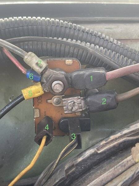

Hi, my car isn’t turning over anymore, I’ve not been able to get it started yet since I imported it a few weeks ago but it has previously been turning over but now it won’t anymore. I took the starter off and checked that and it seems absolutely fine and will turn over when cables 1 and 2 are shorted together. Cables 3 and 4 both read voltages when the key is turned in the ignition to try and start it, are either of these supposed to be an earth? Please could someone explain how is the relay grounded? Really confused and want to get it running before it’s registered in the uk as I’m so keen to drive it!

one of those terminals should be hot with key in "crank" position (i forget witch one, smaller wire to the starter). it wasn't
ground is done through the neutral safety switch....... you can bypass it simply by grounding the G terminal.....make sure the car is not in gear

Hi, I tried replacing the battery terminals as they looked super dodgy and still wouldn’t turn over so I put it in Neutral instead of park which it’s been in the whole time and it will turn over when it’s in neutral! where/what is this switch that needs it to be in p or n as seems like it is out of adjustment like you thought
Here is the switch on Rockauto. It is located on the left side of the transmission. There may be wear internally where it works inside the transmission. HOWEVER, a lot of times it is just wear and "play" in the linkage. Try putting if firmly into park, and/ or jiggle the shifter while turning the key. That should give you the answer.

thank you so much! will try this and fingers crossed it will work :) never heard of that switch before so was super confused why it wouldn’t turn over anymore but that makes a lot more sense now, thank you for explaining it
