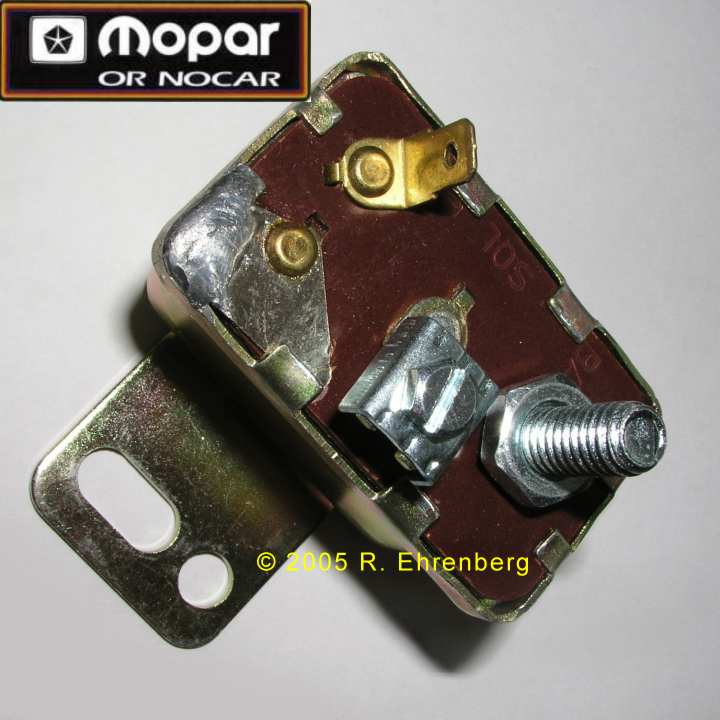

check the starter relay on the fire wall make sure its getting full voltage in start position . if its no good make sure you buy a good part dont go cheap. did you buy a rebuilt starter ?( if so they are JUNK). INSTALL A MINI STARTER from a 97-99 v8 mopar truck . when the engine cranks over does it sound like its struggling /craking banging sound slow raugh raugh rough or a fast raugh raugh . checking the charging voltage of the alternater and battery reserve . check all conections any sign of green stuff cut up about a /12 to 1 inch . it grows and climbs up the cables ---> replace cables (dont clean waste of time). check for loose conections /starter too close to flywheel
make sure the starter relay is GROUNDED to the fender apron , metal on metal
you should have this type of relay which is grounded through the case to the body
