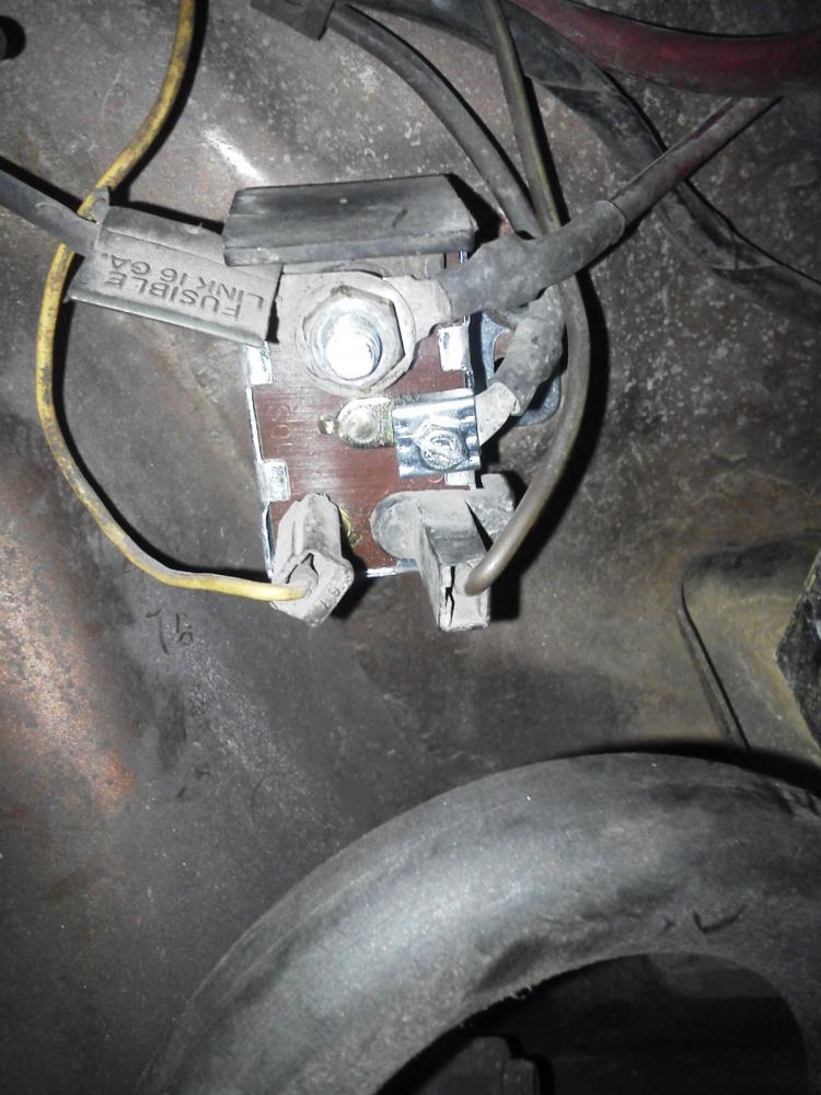

thanks for help, i'll check the battery. i had it on a trickle charger while i was gone, but doesn't necessarily negate it. and i'm unsure how you go about jumping the relay, which points am i trying to connect?
I bet battery. 90% of the time just not enough umph to kick the starter over
Its possible with battery, happens a lot and if it set for a length of time, trickle may not do it.. Meep is right with jumping the relay, just a screw driver to them should turn it over, try your solenoid to, if nothing happens its likely battery or bad starter, i know you replaced it but it happened to me last summer, lot of playing over a bad starter, it happens though, good luck.
