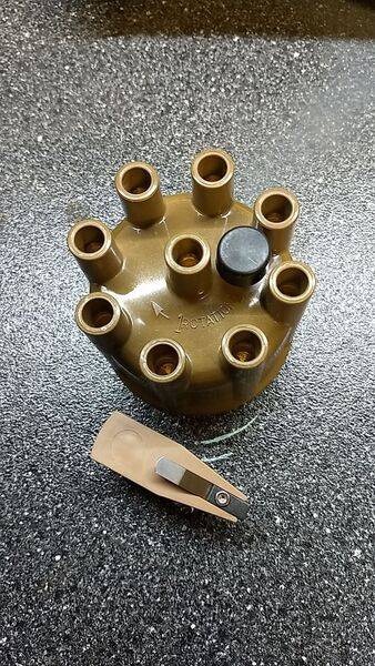

So I set the timing gear in and got the distributor set with the rotor pointed at #1 cylinder
when I set the cap on the distributor assembly, the rotor is pointed at #4 (inside the cap)
Am I off or do I need to adjust?

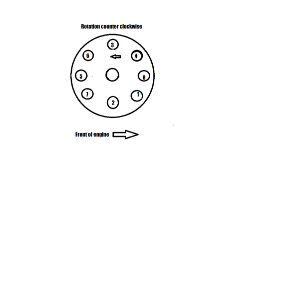

number 1 is in the 5 o clock position looking down at the distributor that's where the rotor should be pointed
I should point the rotor at the #1 inside the cap and not at the #1 cylinder?

The rotor does not know where #1 cylinder is. It only knows what tower #1 is plugged into.
Yes it does! It will tell you where #1 is. Put #1 cylinder on compression stroke with timing mark at TDC and that’s #1, the rotor knows. Where you want to put the wire by following that chart doesn’t mean anything. You can move the rotor to face any direction for #1 by moving the distributor drive gear.
Maybe there's a preferred location?? I don't know but the process is extremely easy and I never worried about where #1 ended up unless there was a plug wire routing issue. As mentioned, bring #1 up on the compression stroke.. I personally set it at 12 degrees BTDC then line up a tower with the rotor and that's #1 regardless of where it's at.

I think he means he's pointing the rotor physically toward where the #1 cyl is on the block ?

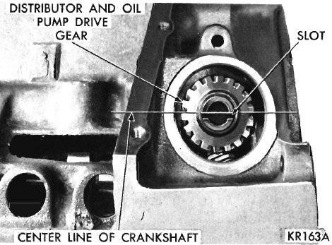

everything will depend of the oil pump/dist shaft indexing. If correctly done... well, will match the one on cap
