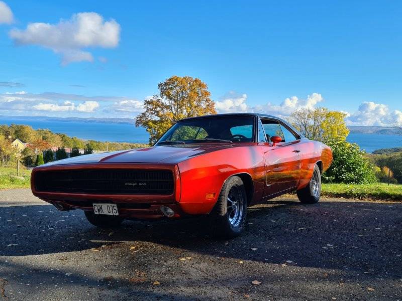

I think i have asked this before but i want to get me som black steel rims with the small hub cap.
I want the rear wheels to really fill the wheel house, i think 275/60 look good, the width of 295/50 looks good but sometimes the hight looks weird.
So if i go with 275/60 what backspace/offset im thinking of 8" rims
Show me som pics for some inspiration!

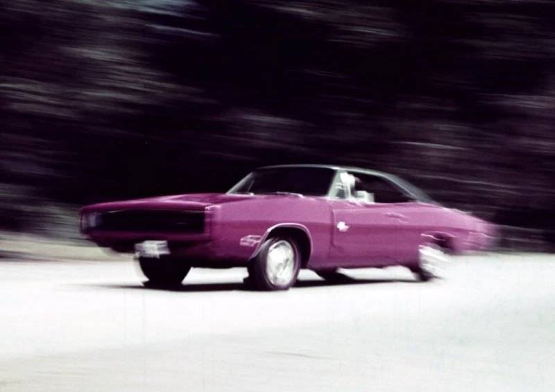

Chrysler actually contemplated doing it for the ‘70 Charger. Theses screenshots I took from a promotional film of the new for 1970 Charger show a red car with red painted bumpers. It doesn’t look like they are elastomeric.

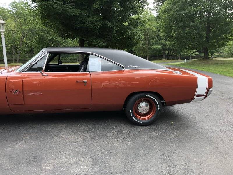

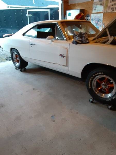

Don't do it! Those steel wheels with the dog dish hubcaps are so overdone! I put these on my 70 Charger R/T. I painted the center spoked section to my liking!
15x8 ramcharger wheels, 4" b.s, 255/70x15 on the rear, 285s wouldn't fit. 275/60 would fit fine on your charger, because of your open wheel house.
(1967 barracuda hubcaps)
Edit: 4.5 backspace fits much better. I have some 16x8 tt2's with 4.3/4 bs with lots more tire that fit better than the 4"bs steelies.

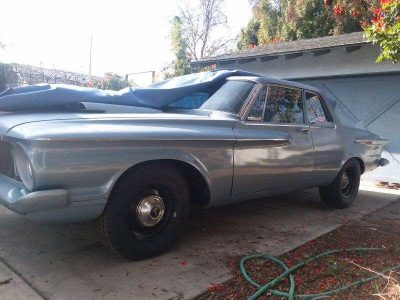

I painted the bumpers on my 62, cause it was $1000 each to straighten and chrome em here in california,...... and it's just a bracket car.

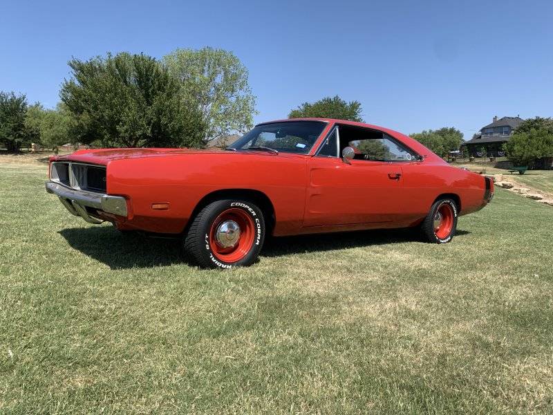

No 70 Charger had those lame *** dog dish hubcaps on them past day two of ownership when they were new ,if they were even ordered with them at all as most weren't. I know I was on the lot in 1970 when my parents picked up their new 70 Charger R/T SE. Only taxi cabs and cop cars had them.

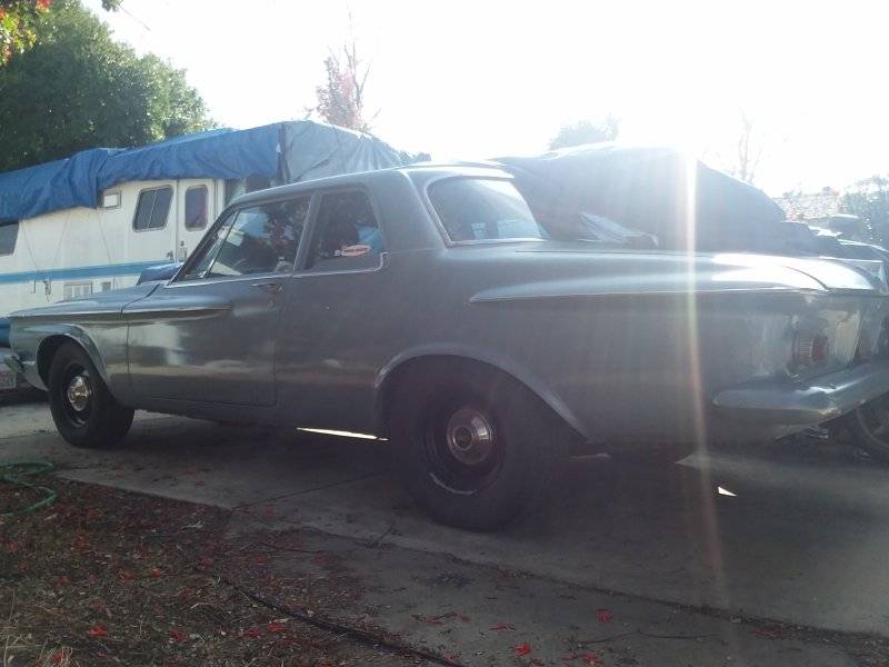

15x8 F, 15x10 R is on my 69, because it's a 69.
If I had a 70, I'd put the same size on it, but with the Rallye wheels.
Rallye wheels don't look right to me on a 69, only because I know they didn't come out in 69.
