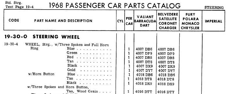

...codes for the column and the wheel. ...color.
This will probably answer your questions regarding colors - info is from '68 parts catalog based on prior threads? The broadcast shows an "Assembly number" (such as "12X" - which you couldn't 'buy' per se) for the Wheel/Horn ring pair - is not the "Catalog number" (in this case, for the wheel alone) that's in the parts manual - which you could buy. There may be others - I didn't ferret the whole section.
That’s exactly what I was wondering about. Thanks a bunch. I really appreciate it.
