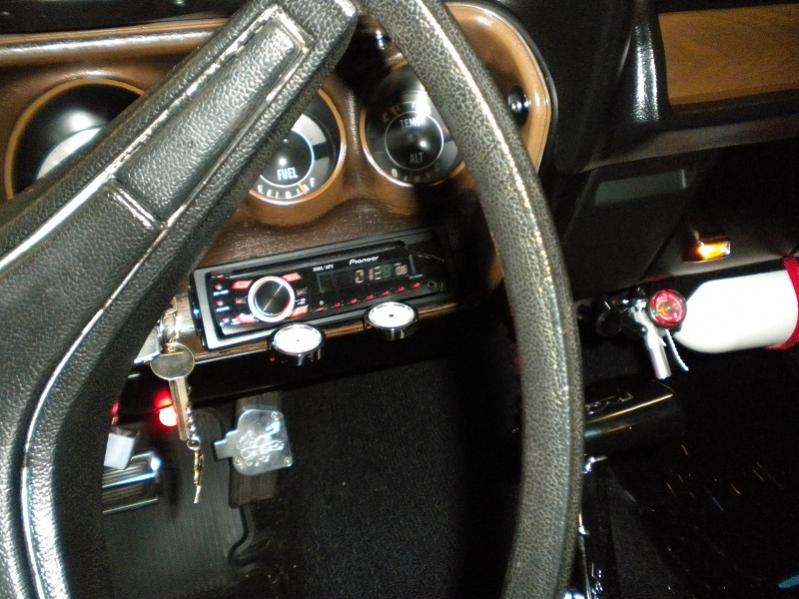

:icon_study: I plan on replacing the dash bulbs in my 73RR and was doing some reading on the subject from some past posts...I am curious about "dropping the steering column"...is that an involved process? Marla

For what is is worth Marla, I have never had to drop the column to change the bulbs, I can reach them all from behind...ok ya I don't have Hulk Hogan arms but they are getable.
AL
X2...i was going to tell you that earlier...i however do have hulk hogan arms and i can get to all of my bulbs....not easily ...but im sure youre not a 6-5 260 pound man either. if i can do it,,,you should have nooooooooo problem!

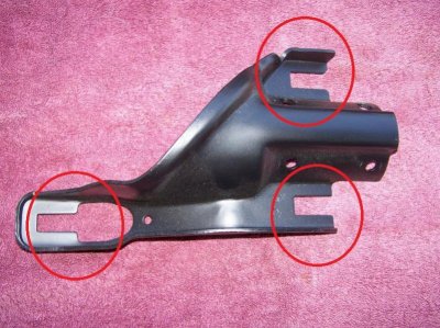

dropping the steering column to get to the instrument cluster makes removing the cluster to remove bulbs very easy and I recommend it for those who do not want to have a second profession as a contortionist.
see pics attached, there are two nuts (mounted to studs) and one bolt you will need to remove in order to lower your column. There is also a ground strap attached to one of those studs that will need to be removed in order for it to drop cleanly.
make sure when you remove your cluster that you pull it out slowly as some wires may get tangled and pull on each other, just take your time and you will be fine.
let me know if you have any questions.
