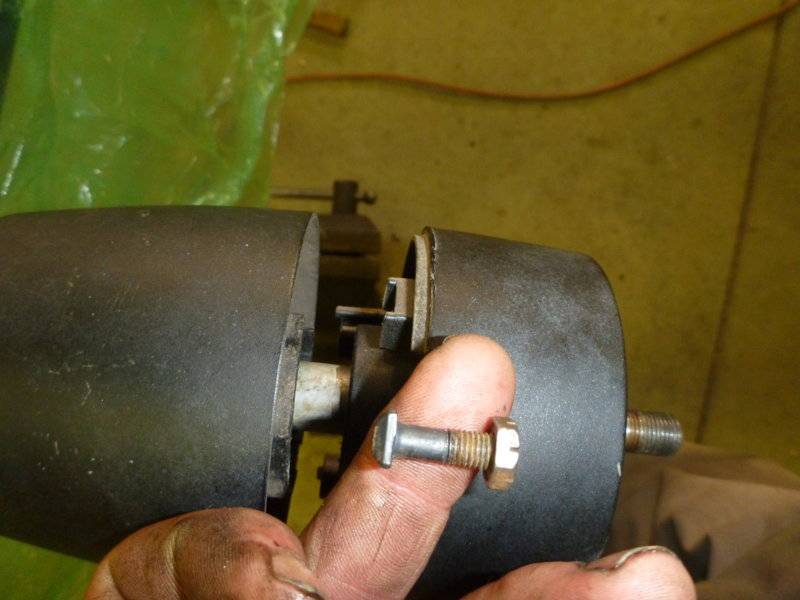

I am going through the rebuild on my 1969 Coronet steering column. I started taking it apart and two square headed screws fell out end of column when I started disassembling it....OOPS. I took a few pictures while tearing her down but wondered if anyone could reference me to an exploded view of the entire column? I have the maintenance manual but it doesn't really give me what I need to make sure I get it right. I ordered the turn signal assembly and am changing from an auto/ column shift with no tilt or telescoping from factory to floor shift ( bought the collar from Andy's) . I tried going through past posts but didn't see a schematic referred to. Thanks in advance....I know someone has asked before......

Do you have the parts catalog? They usually have the exploded view there. Look in http://www.mymopar.com/index.php?pid=107
These? Bolt goes in slot, nut on loose to hold it there during collar assembly. Justin's GTX thread covers it's assembly pretty well, as does my Bee restoration thread. I had issues figuring those bolts out and how they "catch" to hold and Justin bailed me out!

Awesome responses and referrals gentlemen! I KNEW you would be able to help me......thanks for the explanation and pictures Dadsbee!
