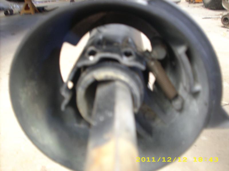

Ok, this one got me. I am sure you have heard a million times, "I took my column apart to restore, and I have this little spring....". Yep, it got me too! Can some show me the exact routing of it, please?

Don't have a picture,but i think the spring goes under the lock plate on your steering column shaft and that is held in place by the "c" clip that fits in the little groove.Put the spring on first, then your lock plate,push down lock plate then fit clip in groove.Hope that helps.
I am sorry, maybe I didn't explain this spring well enough. This is a floor shift locking column. The spring goes from the top of the column, to the collar that you push down to get the key out. I have tried several ways and it seems to bind up. Any help would greatly be appreciated!

Ok, after much thought and experimenting, I finally got it right! During my internet search, I found a couple of other people that had the same question as me, without any answers. So...I am posting a picture in hopes that it will help someone else out too!
David

Ok,glad you got it fixed. Sorry about the misunderstanding on which spring you were talking about.
