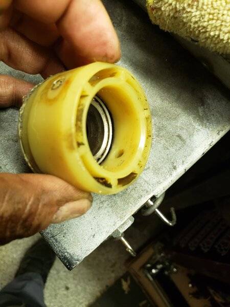

Since we are on the subject I need lower support bearing for my 69 charger. Any suggestions for this 7 dollar bearing that seems to cost 90 bucks?
Is this Richard too? Can I press out that bearing or need the plastic pc comes with it and the bearing isn't serviceable?
anyone know if you can push that lower bearing out ? or you have to buy entire plastic housing. i dont want bother to attempt if it's not possible.

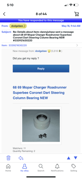

This guy on eBay had/has 2 of these, looks like yours
so i didnt find find this exact seller on ebay , maybe he sold out. i did find some others but still 90 bucks or so . going to keep digging. i might just make the collar on the lathe and press a bearing in it. Use the extra $90 to buy a tank of gas instead. lol

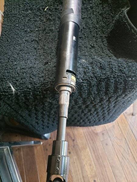

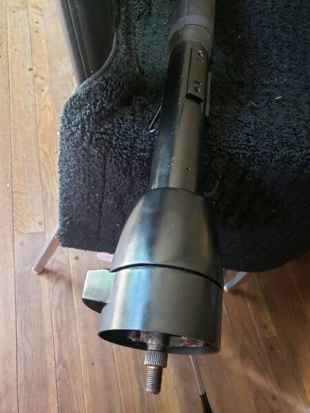

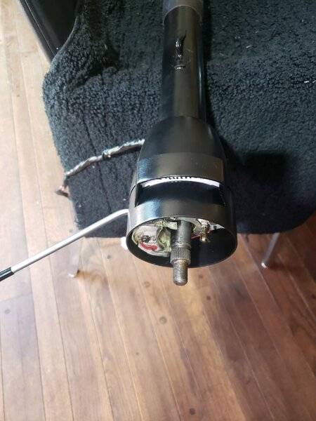

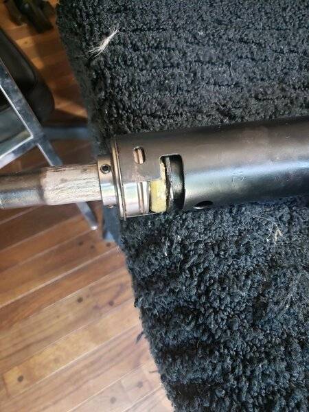

thought i'd update this with my rebuild of the steering column. End result rolls fantastic and cost $7 on ebay. i replaced upper bearing too , i purchased that from DM , i suppose i could have got something from local bearing shop... i used two set screws on outside of the lower bearing that came with it and it's a completely sealed bearing. also used part of the old plastic bearing housing as a spacer to keep the alignment of the shifter tube so it wouldn't rattle. i deleted the column shift altogether and welded the top so it wont roll. i use a floor shift, so the hardware for the column shift was all removed minus the tube, you still need it to assemble the column correctly. but i also i fiberglassed the hole for the shifter arm i cut off and gave everything a new coat of satin black.
pretty happy with the results.
