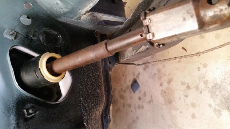

lower column pic
Here is a pic. Of the shaft sticking out of the tube on its way to the gear box. The white plastic ring pops in and out by pushing three tabs, but as it sits installed there is about 1/2 inch of slop in the shaft. It sure seems that there should be more in there to take up all that slop. It doesn't appear as if it were ever disassembled. ???? Of course once the end of the shaft is installed to the steering box there wont be any play but it sure doesn't look right to me.

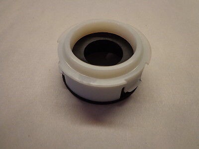

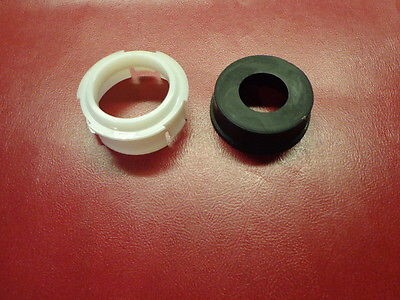

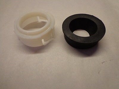

Cmmopar,
Thanks for the link! I think the second picture is correct and the only part that my column is missing is the rubber donut ring. The white plastic is there and in good cond.
I dont think the first pic of the bearing could be installed in the tube on this 72 slapstick steering tube.
Cmmopar
Thanks 4 the link! The second part is the correct one for my car. The whit plastic is there and in good cond. But the black rubber donut ring is not. I guess i need a rubber ring. The first picture of the bearing could not be installed on this 72 slapstick
column.
thanks again.

Ok, I'm pretty sure that on this 1972 satellite sebring plus with the slapstick console shift
The only bearing is up at the top of the column by the steering wheel. Like Seventy and his 70 Cuda'. And at the lower end of the tube is only a white plastic ring with a rubber seal inside to keep dust, oil, water etc... out of the column tube(the second part that Cmmopar listed above). The support of the shaft in the tube at the lower end, as far as I can determine is from the shaft adapter connecting to the steering box.

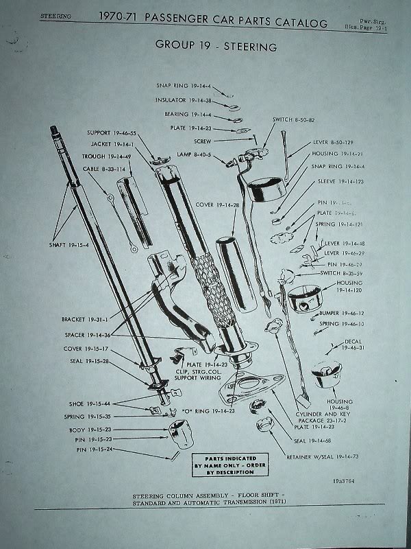

Thanks Cmmopar,
That is the only illustration of the standard floor shift column that i have yet to see.
That is what I have.
The seal was foam from the factory it wasn't rubber
