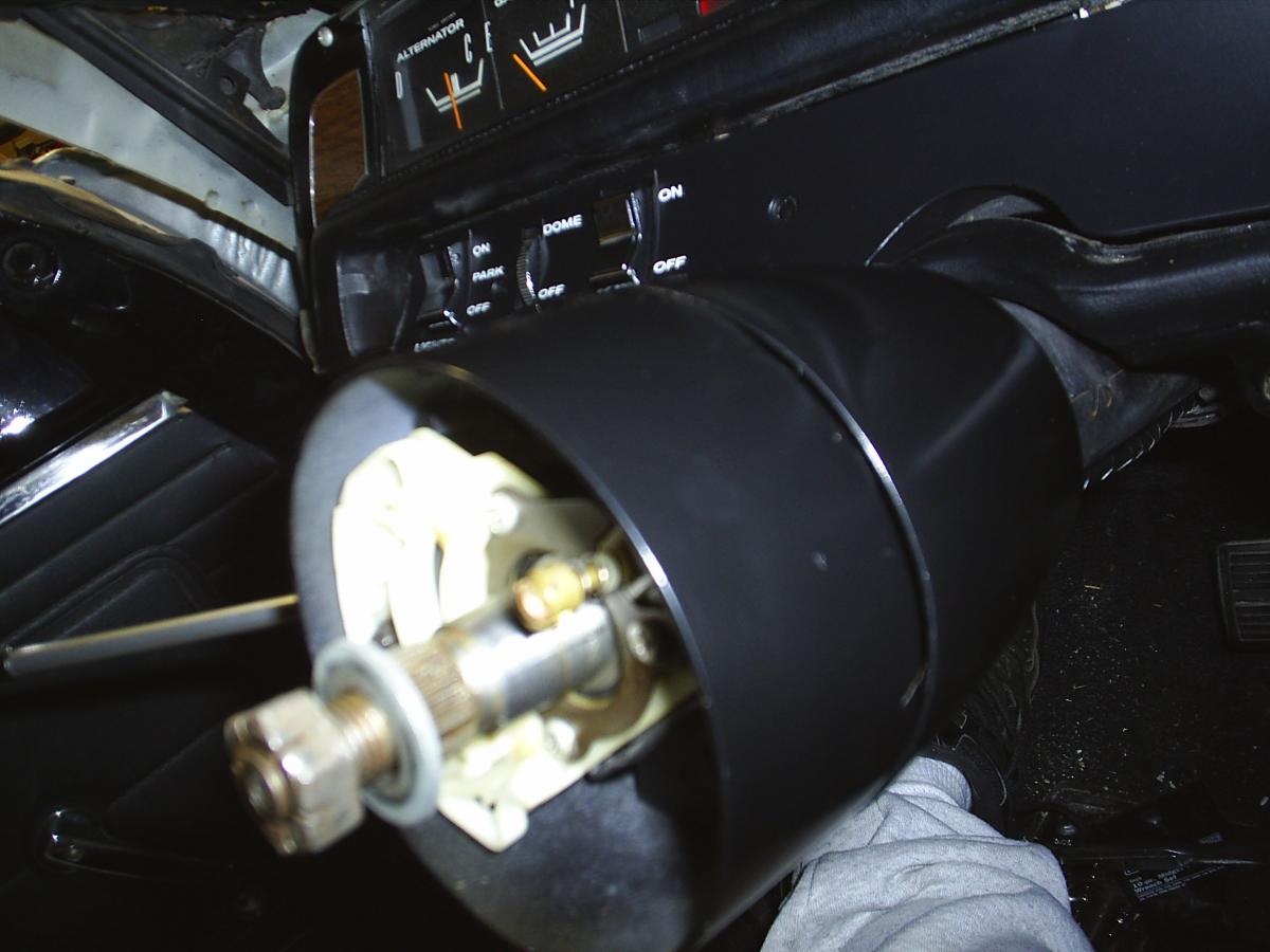

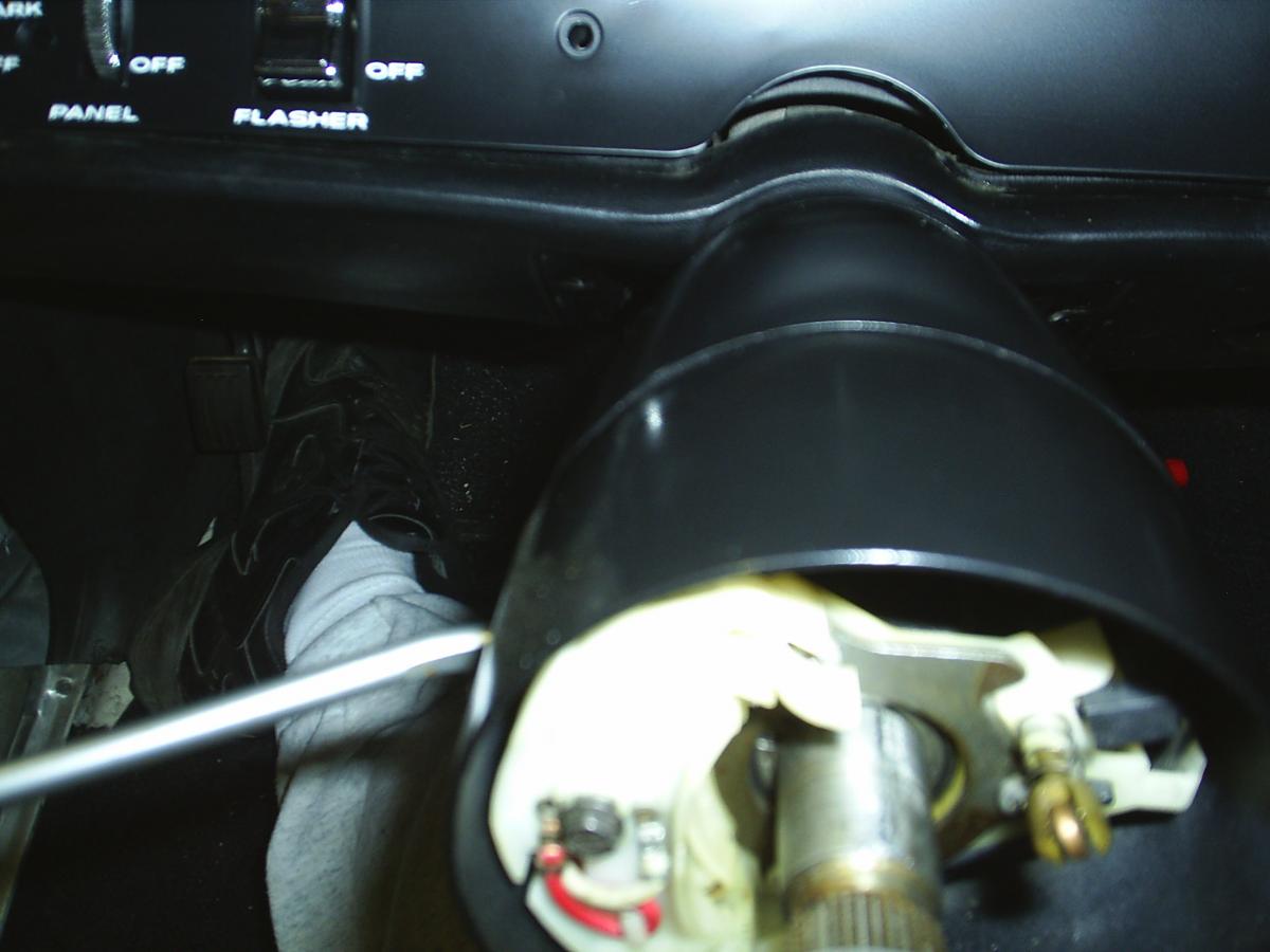

I've changed several columns from auto to floor shift by grinding off the attachment point and the selector piece and used epoxy to fill them in.Doesn't take much time at all and will not be visiable if you take your time,not much different then doing body work.

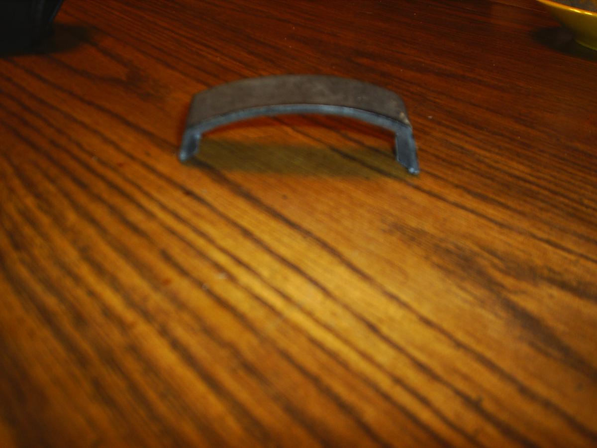

hmmmm...can you post a picture of a column you've done this work to?
here are a couple I took The one is the piece I removed from the top which had the PRNDL I don't have the other to which the lever was connected to.I took a cut off tool and removed them ground them down and put a piece behind the hole to keep the epoxy from running out and filled. the gear pointer was a little harder and needed a piece to fill in about a 1/4 x3 area.I made it from a piece of 1/8 scrap and also epoxied it in place.The column parts I think are pot metal and epoxy sticks very well. The first one I did was over 20 years ago and looks as good today as it did then. sanded with a d a and refilled as needed.primed, sanded and painted . Sounds harder then it is. I'd be glad to do it for you but I have no doubt you can do it as well as me.
Its really not that hard to do but thanks anyway funny story I bought a tilt column for a 67 Chevelle which are hard to find and it was a auto column. I couldn't figure out how to take it apart to do the work and didn't want to ruin anythink so I went to a junkyard and bought one out of a Pontiac for 10 bucks and used it to figure out how to disassemble them,not hard to do either if you know how. Quite ingenous how they work,reminds me of a rubeks cube inside
