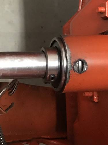

GERST sells a bearing to replace the bushing in his kit. Reduces play and improves feel.

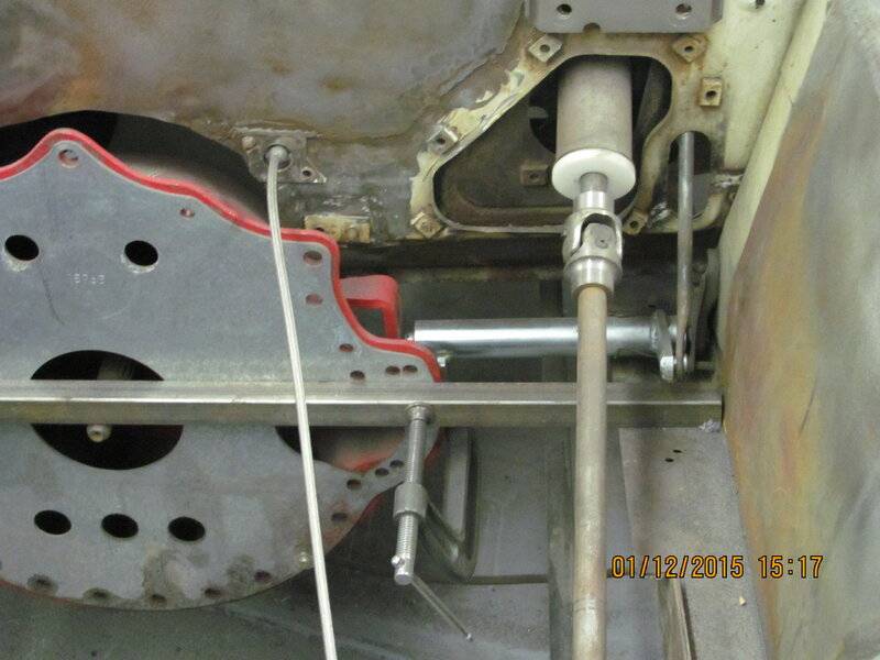

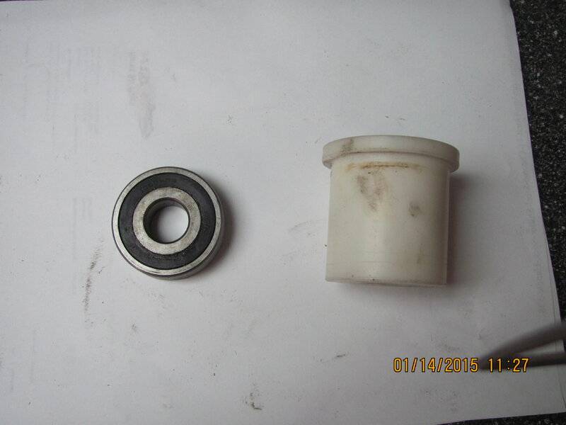

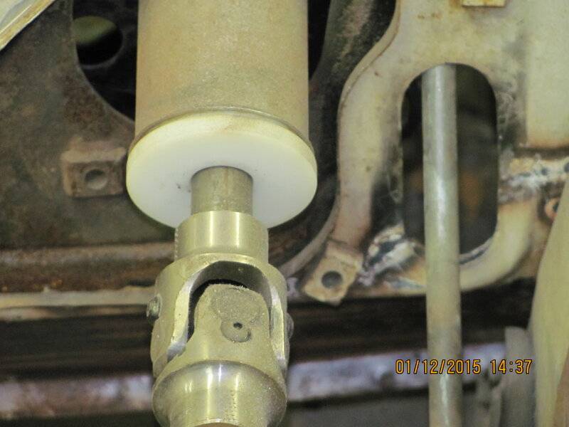

Here is what I used for the bottom of the column tube , A friend made up some bushings that help support the lower shaft going in the box . It was made from some sort of self lubrication material . Was going to use a bearing but this was easier and better . I have one of the factory seals that go on the bottom if I can find it you can have it .
