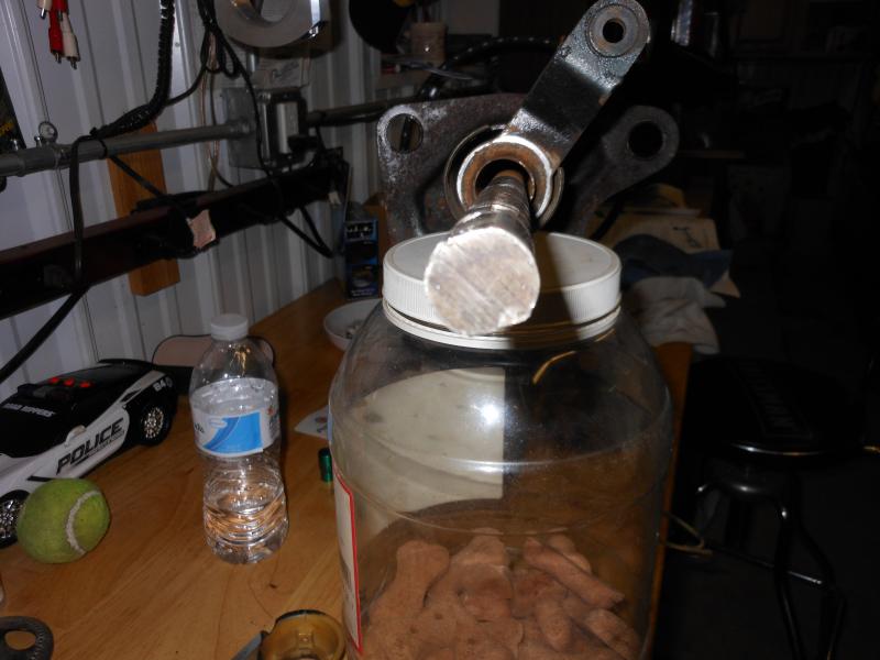

recently removed steering column to replace coupler.According to these pictures am i missing something? latest pictures 006.jpglatest pictures 007.jpg

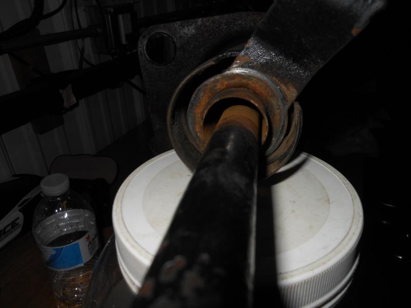

i cant see the lower bearing? is there supposed to be one there?
I have the lower seal but it keeps falling down.Is there a bearing or something that goes on the shift rod?How do i keep the seal from falling down?
I have the lower seal but it keeps falling down.Is there a bearing or something that goes on the shift rod?How do i keep the seal from falling down?Also have the white plastic cap that is held in place with 2 screws.

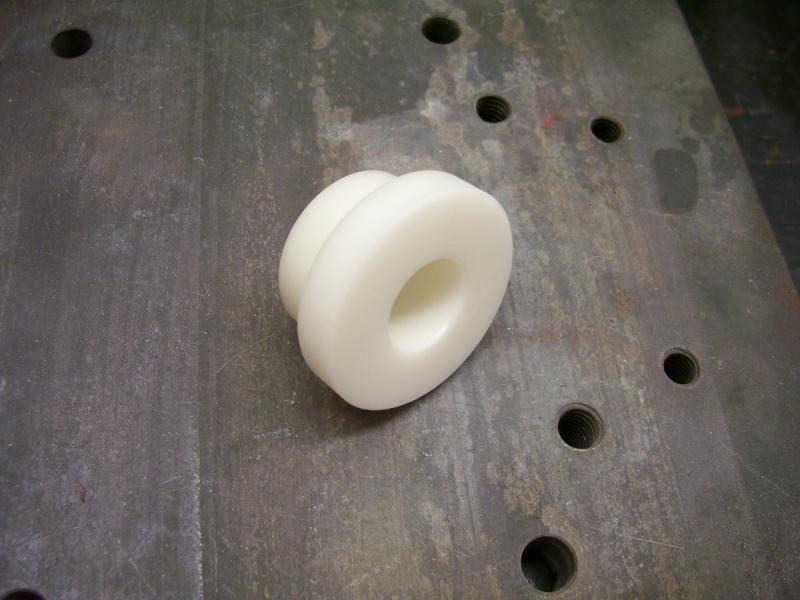

i had some these made to fit in lower section of my 65 coronet column. don't know if it would work on a 66.
Is that the white plastic piece with 2 screws?
homemade jobbie to fill the bottom of the column and give the shaft something to rest on. works great in my 65's column. by the way, my 65 column does have 2 screws that hold this in place.
