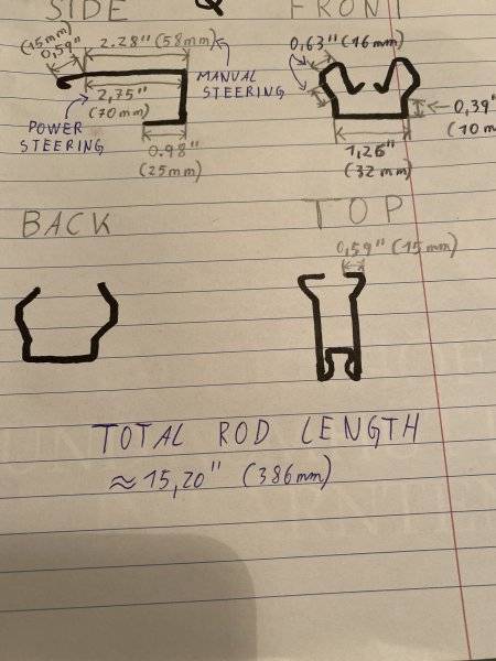

Steering coupler pin measurements

Hi FBBO!
I made a quick sketch for a DIY safety pin on the steering coupler. I ordered the wrong one so I made one by myself to save some money. I recommend to make a test piece out of aluminum to make sure it really fits tight its not 100% accurate I am sorry
Measurements are in Inch and millimeters just what you prefer more.
