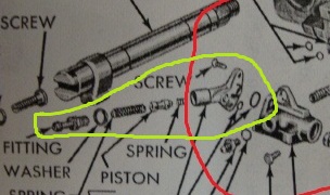

well i was wrong again i bought a remanned pump off ebay that said it was for my car however once i recieved it i found that it had the wrong size pitman shaft rather than paying shipping to send it back and being out shipping for both directions i decided to pull the guts out of that one and put them in mine (except for the pitman shaft). i got it all put back together with the new guts and it still does the same thing the only way the wheel dont crank to the left is if i have the top adjustable valve slid all the way towards the firewall and when its there i have no power assist to the right. so back to square one and now after studying this pic i am wondering if maybe my problem is in my return fitting valve.
before everthing went to hell i had a trw pump that had the large 5/8 i think hose return line to it and the return fitting on the gear box was empty just a straight through shot. now the new pump has the small return hose and in this pic it shows that there should be a piston with springs on both ends of it (of which i dont have) so im thinking maybe thats whats causing my problem that maybe i just need the extra parts in the return fitting
well after messing around a bit with it today and putting on the new return fitting with the parts i was missing it works now just needs to be adjusted a bit though. i didnt really have a lot of time to work on it so not much got done but its a start. next weekend ill finish putting my car back together and adjust the valve better and see what i got
