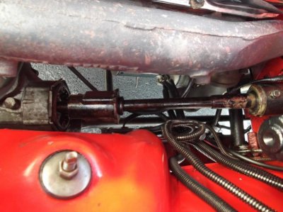

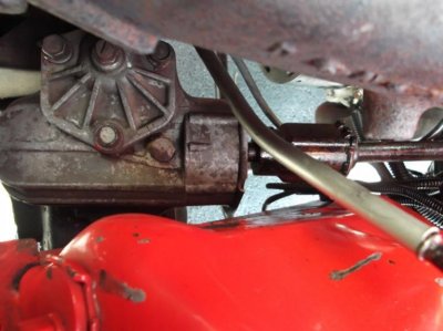

I added some photos
As you can see just in fromt of the steering gearbox has fluid on it.
