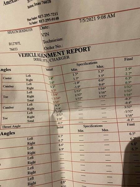

I have adjusted the box almost 3/4 turn to try to loosen it, but still no change.
Car drives straight as an arrow no problem, but when you steer left or right it will stay that way. When You make turn if tries to straighten up, but when you make a right turn it will stay hard in the turn even with no hands on the wheel. I am at a loss. I have been suggested to adjust the valve, but it doesn't turn on its on when running and front jacked up. I have been fighting this for a few weeks now.
Any Ideas?

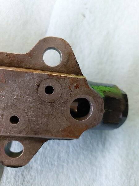

done that already.. im thinking my pressure control valve might be dirty.. gonna take it apart and see. maybe piston isnt returning to center to equalize pressure in and out,,
Might think about adding a tad bit more toe in as well, you are showing 1/16 (it appears), generally I like to run 1/8" or so. Probably has nothing to do with this issue but thought I'd put it out there.
It has plenty of caster. That’s not the problem.

I just pull the power control valve of and it. Looks. Like the company that rebuild. My box didn't clean then valve. I could shake it with no movement.. I cleaned it and it moves freely now. Currently vacuum bleeding it.
Today I pulled the pressure control valve and cleaned it (it looked dirty and you could shake it and piston didn't move) and set it back where it was(once I cleaned it and shook it piston moved freely) . Not sure how much adjustability it has, but when I crank it the steering don't try to self steer so I would assume it's set right... Took car back out and now I can make a right turn and it almost recdmters, but now left turn is kinda hanging Up and not really wanting to center back up. Can it be fine tuned more to improve it more?
