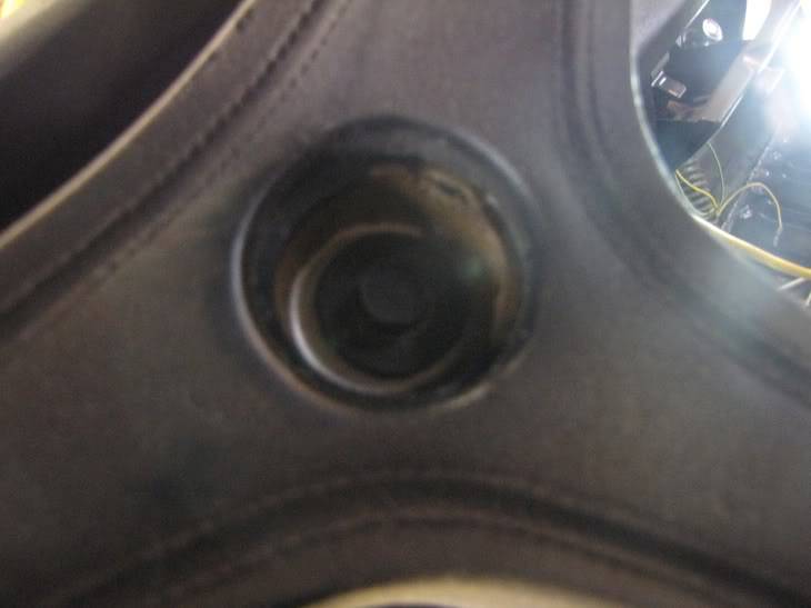

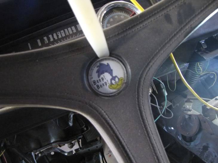

If you look close at the button, You'll see there is a small notch in the button. Use a vinyl trim tool or something light and use that notch to work out the button. There is a small bolt under that to remove, then the center 3 winged cover comes off. Be careful the print/sticker material on the back side of the roadrunner button comes off/scratches real easy.
