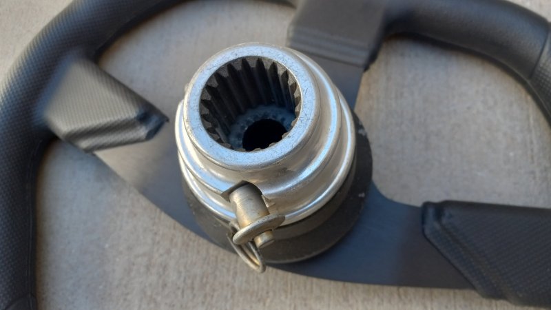

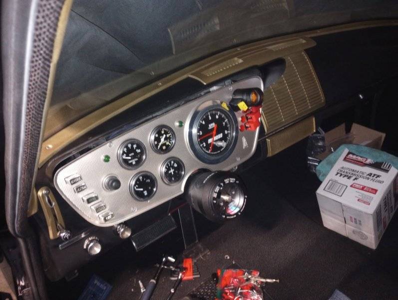

I have a quick disconnect on my car.... but it was there when I bought it.
I have no idea what brand, and I'm pretty sure it's an aftermarket column.
I'm assuming you want one for a stock Mopar column.
I can get pics of mine, if they'd help.

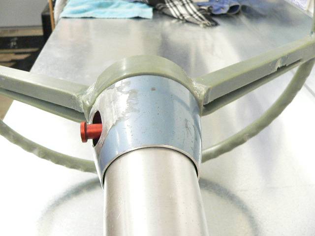

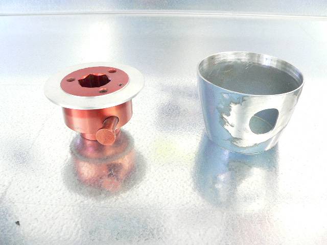

I've got a swing out bar, a wheel disconnect, and a flat bottom steering wheel. (It's a LITTLE car, and I'm 6'3"). And an aftermarket column.
I'd go with Doug's recommendation, if I was you.
