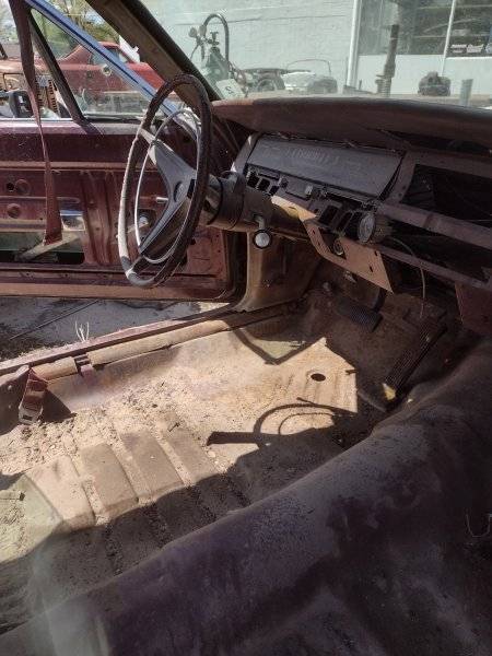

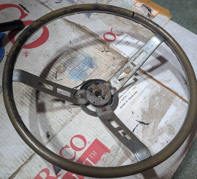

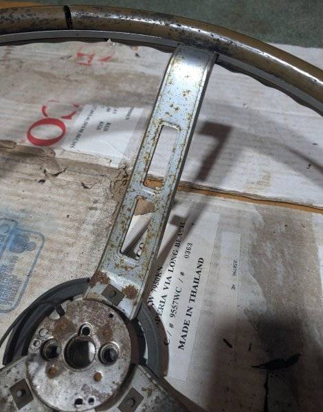

My steering wheel needs to be restored or replaced. I contacted Gary's and with shipping, etc it will be a tad over $900 (wheel, spokes, and shipping). Are the $550-$750 reproductions so bad that I should spend a couple hundred more to use the original steering wheel? Are there stamps or something that would make it obvious that it's a repro? Reproductions are Chrome where the restore would be more of a Chrome paint. I don't mind spending money where it makes sense, just want to be sure I'm not throwing it away.
Thanks
Ross
Pictures as everyone loves pictures

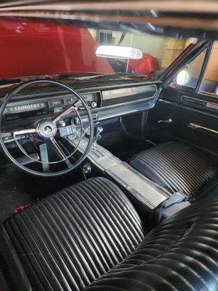

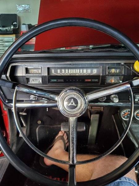

What type of steering wheel. I have repo standard wheel on both my 67 Coronet, and 71 RR.

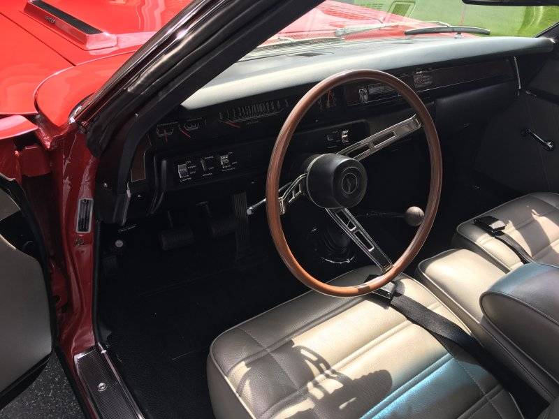

The reproduction wood wheels have spokes that are way to much like chrome. I could stand to have that in my car.
Restore an original.
Good point - I appreciate the input.
Spray it with silver paint, DIY an eBay brown leather wrap, and throw a $870 keg party to show it off to all your pals and people who give you good ideas.
Repro wood wheels are about $800. Since its the same price as having your original redone. I would redo the original.
Worth considering
I repaired the big craters on my 65 Coronet wheel with JB Weld, primed, and sprayed the spokes. Spent $95.00 for a leather wrap and I'm quite pleased with the results. Maybe $135.00 invested.
Mike
The wood wheels are big dollars,I would have my american wheel redone. Chinas stuff is CRAP. JMO
My question is, what state is your Charger in? Interior complete and looks good etc etc? Is the car overall in good shape?
If it's a driver that's a little rough, try a DIY restoration. If she's in good shape and presentable, I would restore the original all the way. The repros are pretty obvious from what I have seen.

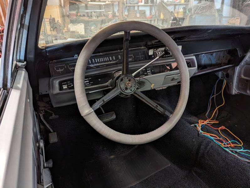

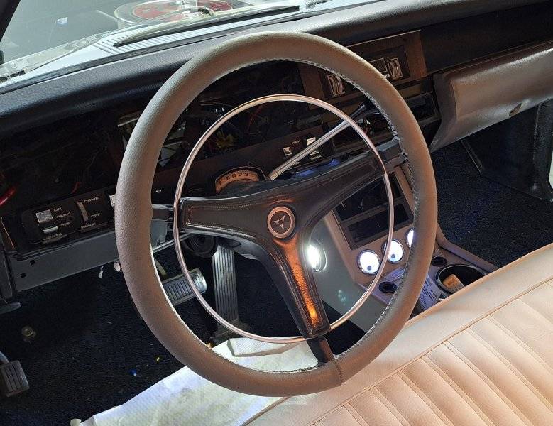

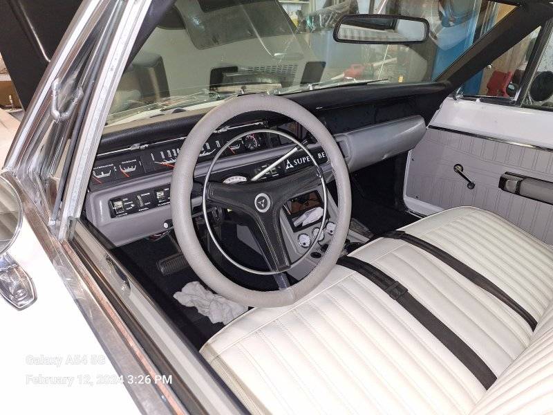

I restored mine by removing the plastic surface. It had been ruined by years of baking in the Nevada sun. Then I found some heater hose that I split so it could wrap around the metal wheel. I then stitched a gray leather kit around it. The other parts were just painted.
