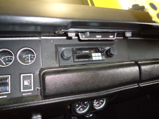

My 70 Road Runner has a dual shaft old school Alpine cassette deck in the factory slot using a factory bezel I got at a swap meet that had already been cut. If you put something in the dash, I suggest doing the same - getting a factory radio bezel that has already been cut at a swap meet for cheap and using it. Mounting the head unit in the glove box or under the dash are also options. There are "stealth" units you can mount anwhere, like under a seat, and use a remote. www.custom-autosound.com is one website.

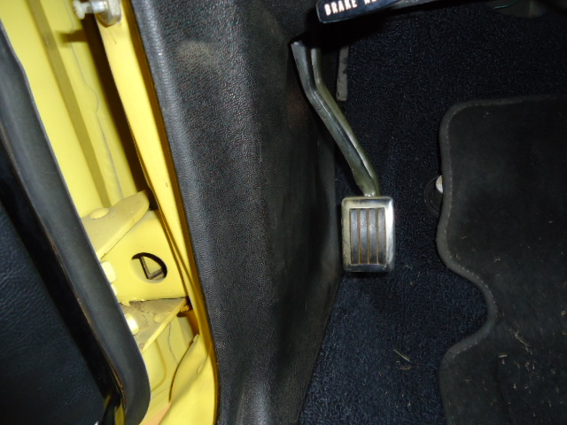

I fit two Infinity 3 1/2" speakers under the grill in the dash. I couldn't find 5 1/4 or 6 1/2 speakers thin enough to fit the kick panel on the driver side and not hit the emergency brake pedal. Some guys get small box speakers and mount them under the dash. I've seen people make custom center consoles with room for the head unit and two speakers, one on each side. If you pop off your door panels you can probably find a place to mount speakers if you don't mind cutting up your interior. It all depends if you want to keep your interior looking stock or if you don't mind letting your equipment show. Good luck!

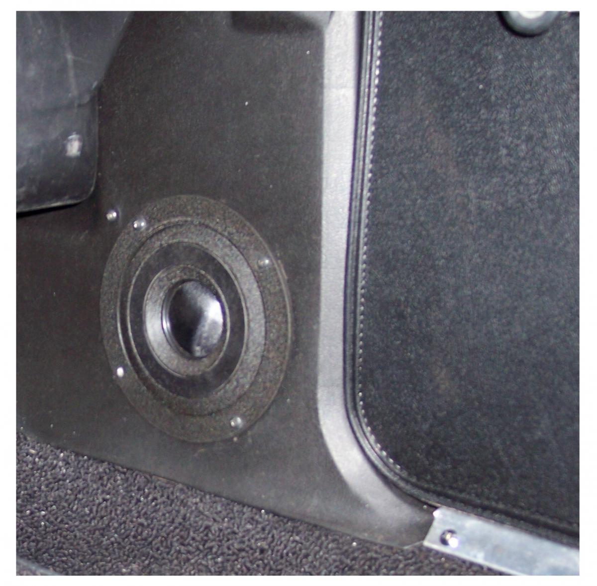

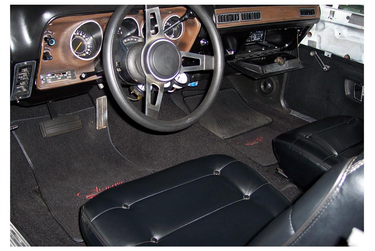

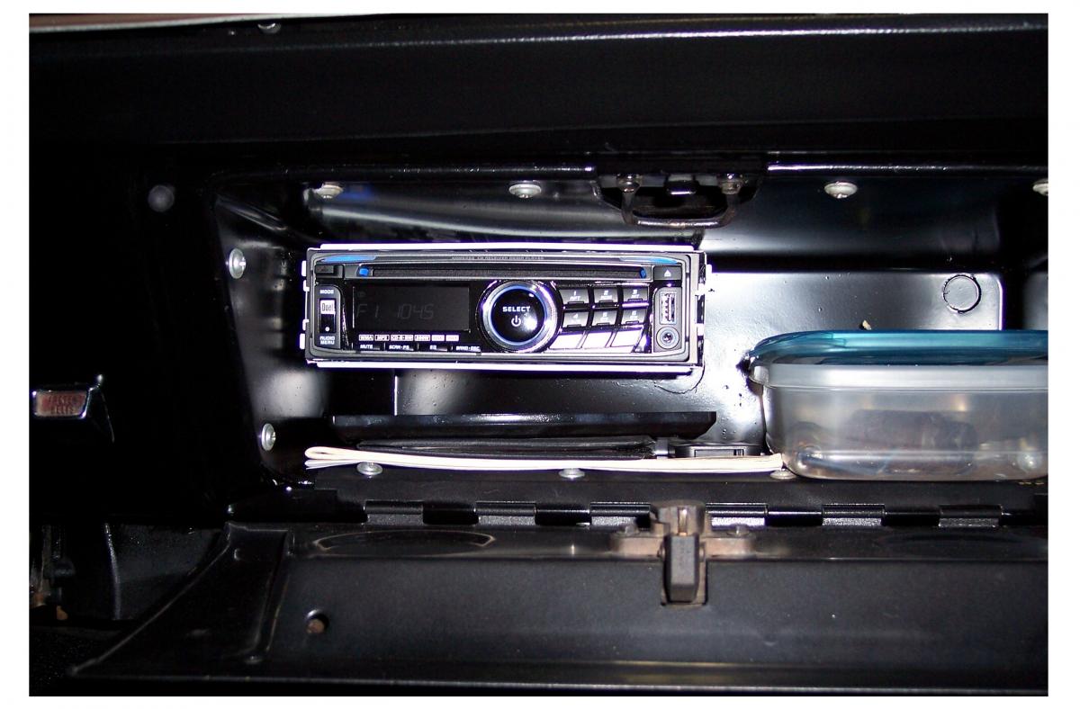

I mounted a Dual-50W x 4 In-Dash CD Deck XDM6350 in the glove box, leaving the original radio in the dash for the stock look. I mounted Pyle-Pro PDMR9 - 5'' Dome Type Midrange Speakers in the kick panels(less than 2 inches thick) and clears the E brake pedal and Kenwood KFC-6982IE 6-Inch x 9-Inch 500-Watt Max Power 5-Way Speaker System in the rear deck from the trunk side so the package tray cardboard would lay flat. This also eliminated using the ugly plastic speaker covers that came with it.

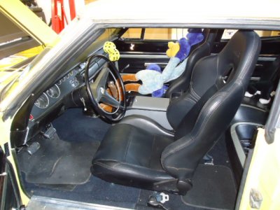

Here is my radio installed, and the reason I can't put speakers in my kick panel. Sorry, wrong pic attached.

This iis the picture I wanted to upload. Sorry!
As a bonus, I didn't drill holes to screw the plate on, and my stereo had DIN (I think)connectors, so I effectively created a pull out unit, by simply lifting and pulling forward, then unplugging two connetors and the antenna lead.

Hey what are those seats in the wrong picture?
That all-vinyl pair is for sale for $150 with tracks plus the ride. The logo looks like 3APC Racing or 3R Racing. Really comfortable and they hold you in on the curves. They don't have a flip forward lever so getting in the back seat means cranking the recline knob. Summit Racing sells similar seats WITH a flip forward lever (which I am putting in the car now) and tracks - SUM-G1159-2. They also have them in beige and grey.
Kick panels look good.
Did you use a template...awfully straight lines of holes.
What holds the speaker in?
I forget what speakers I bought, sorry, they were from some big online steareo warehouse.

Thanks, I spent an hour or so walking around menards to come up with that one. Speakers are attached to the car body with metal strapping by the way, nothing fancy
