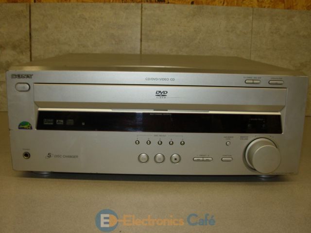

This is what I have. It's a Sony AVD-K800P. I have a 6 ohm subwoofer already. I may just wait and get 6 ohm surround speakers. That sounds like the best thing to do. Thanks yall.
