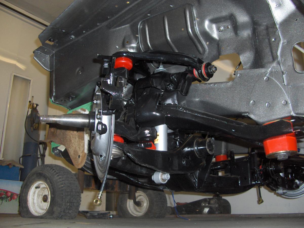

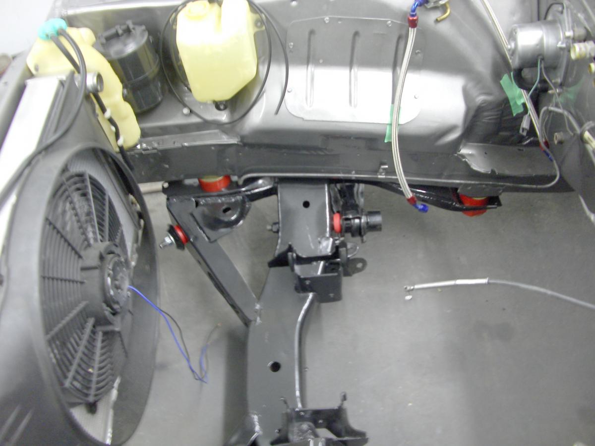

I went to summit and got everything in polyurethane but have yet to try it out.The only problem I had was with the strut rod bushings they are to small I think they are for a 196?'s Satellite but they say they are the rite part.???Check it out....
