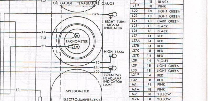

They use different tachs.
So I'm thinking that would be the a way since the wire may be different.
Here's what is in my 67 factory manual.
Compare that to what you have maybe.
P4 is listed as dark blue with tracer.
T11 is grey with tracer.
T13 is dark blue with tracer
@gibber may weigh in on that.
