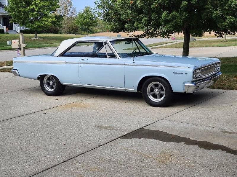

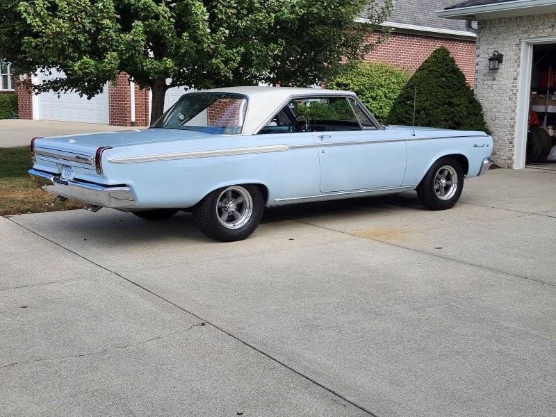

I have a 1965 Belvedere 2 door post and I'm looking at suspension options. They rate the drop from stock. I bought the car as it sits in the pics lowered in front and I'm pretty sure it has different springs and hangers in the back. I have no reference on what the "stock" stance is.

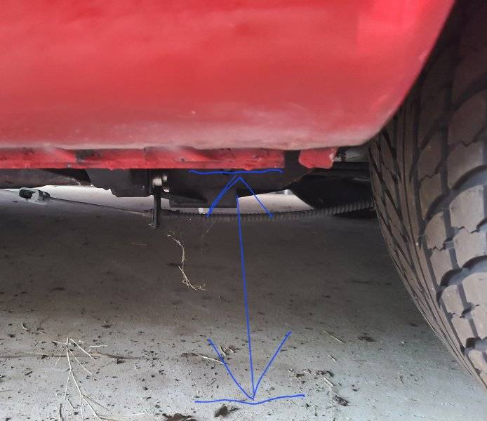

Can some people with a bone stock stance provide the front and measurement from the ground to the bottom of the spot welded seams as shown in the pictures? The front one is behind the front wheel and the rear one is in front of the rear wheel. Please list your tire size as well as this changes the ride height.

IIRC, an FSM will have the stock ride heights listed but measuring from the body seams isn't the place you should measure from. There's some areas on the frame rails that are used according to the FSM. Also, if you do not have the stock tire size on it, then you will have to take what's on the car into account. I like the stance of it as it sits.....
