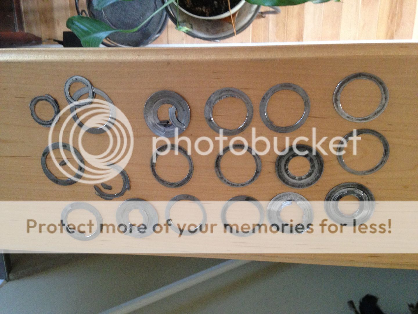

Run correct valve train or learn an expensive lesson like I did.
This was a combination of too light a spring and an improper installed height. Needed much more pressure for the cam I was running. Because I was keeping tabs on my oil and cutting my filters apart after every race, I caught this before I lost everything.
The cost to fix it correctly more than doubled what I should have had to spend if it had been done correctly the first time.
Take the time to learn from those who understand spring pressures and valve train and save some head ache and money.
I wish I had.
