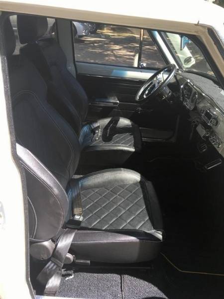

Procar Elites (not my car - this is a Dodge Charger)

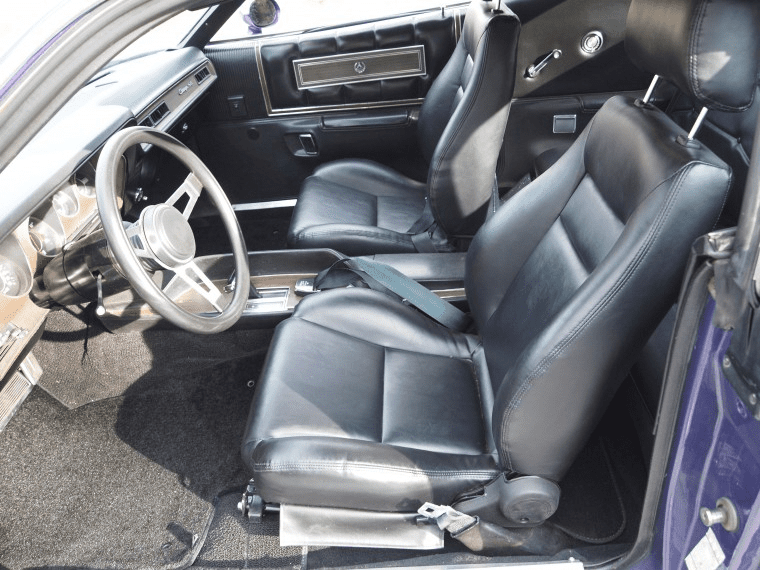

Procar 1680s

I went with Dodge Neon SRT4 seats in my red car...
They do look different from stock but they are far more comfortable and they hold me in place. I can drive for hours and get out feeling as spry as I do in my truck. The stock seats looked nice but had almost no lateral support.
