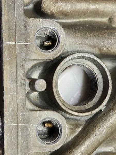

This picture shows the idle jet (idle feed restriction, low speed jet, whatever you want to call them); the small brass tubes.

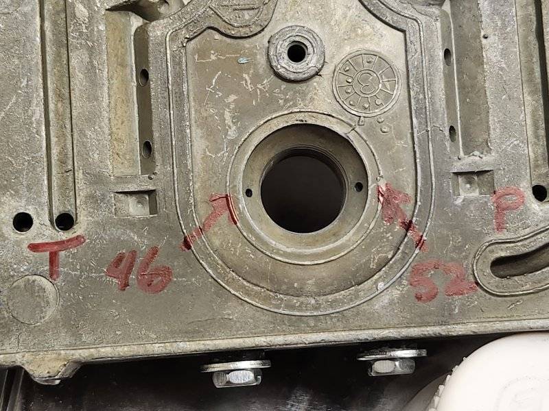

PVCR is .046 thanks and .52?
Was that stock or someone open up ?
