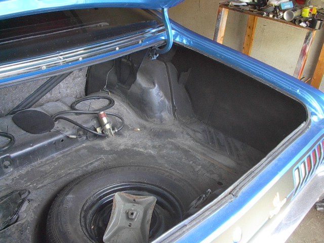

well....I posted a pic of mine on A bodies and got criticized for the location....above the tank..."won't work"....too much rubber..."won't pass tech inspection" and in the trunk..."not a good idea"

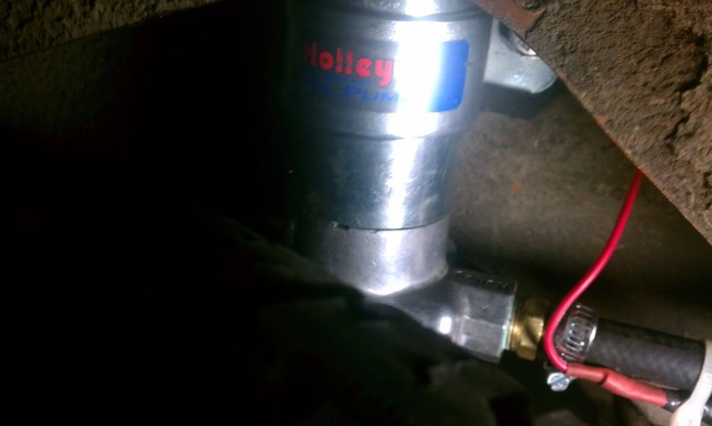

This particular pump came with the car and I'm amazed how quiet and how well it works now for over 3 seasons. First electric I've had and I'd say whoever makes it; makes a damn good pump
I was using one for a minute, had it mounted on the frame rail rear just sat below the tank line. Back to mech pump.
