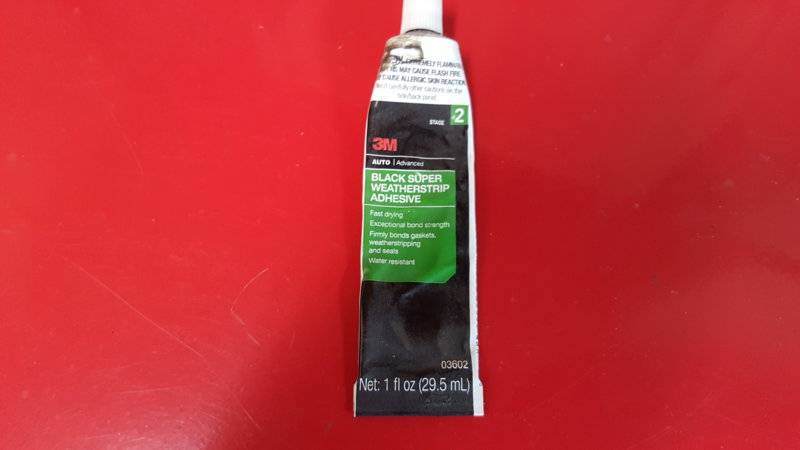

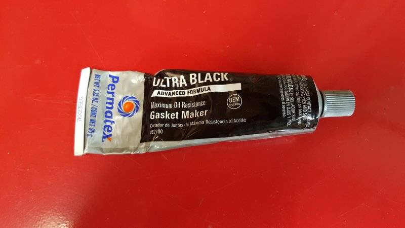

I have a set of Cal Customs aluminum covers and they're not perfectly flat. This is what I used and they don't leak.
Start off with perfectly clean and dry valve covers. No silicone residue, no oil containment (clean bare metal with lacquer thinner or parts cleaner. Flatten out the area at each hole so it's flat, not dented from the last time they were tightened. Perfectly clean the head also in the same manner.
Use the black felpro gasket and glue it to the valve cover with 3M black weather strip adhesive. Let it dry.
Then apply an even coat of Permatex Ultra Black Gasket Maker to the gasket. 1/8" Thick.
Set the cover on the head immediately and only finger tighten the hardware till the gasket maker just starts to ooze out. Let it dry for one hour and then hand tighten with a 1/4 drive socket. You don't need to tighten them any more than if you were useing screws for fasteners and a screwdriver to tighten them.
Let the sealer cure for 24 hours before running the engine. Guarantee this will work if you follow the directions to the letter.
