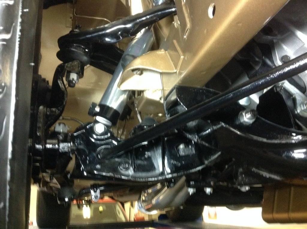

I'm wondering what you guys are doing for upper control arm upgrades. I'm running stock uppers with the offset bushings in mine, but I'm concerned about them not moving freely enough to allow optimum weight transfer. What's working for you guys. And is there anyone running the QA-1 52305 tubular uppers and how are those?
Don't worry about it. You usually have to slow the front transfer with the shocks anyway.

I've got a full 6" of travel also. Thinking about the upper arms I separated the upper ball joint on one side and found the upper control arm quite stiff, which is what got this thread going. Mike if you don't mind, what are you doing for upper control arms and bushings?

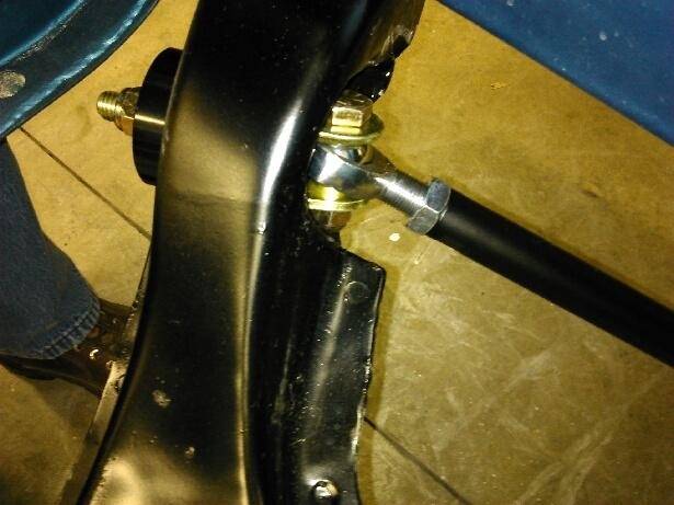

Malex, I put all new suspension on my car and made sure to lube everything to help with movement. Seemed to help. I also think the adjustable front link helped too. It has a swivel at the one end instead of just the rubber bushing.
Rod was a PST part, I think. Yes there is some resistance but not as much as when I put it together dry. I wasn't to worried about the compression resistance as much as the extension resistance. Actually the torsion bar will help with that. Usually for race set ups you want a 90/10 for the front anyway. (frontend up easy, compression down, slow). BTW I used the PST poly bushing kit for the front suspension.

Thanks again for the information. My front suspension is new except rubber offset upper control arm bushings. The resistance in the control arm when moving it through it's travel had me wondering if that could be an issue.

Nice chassis Malex!
