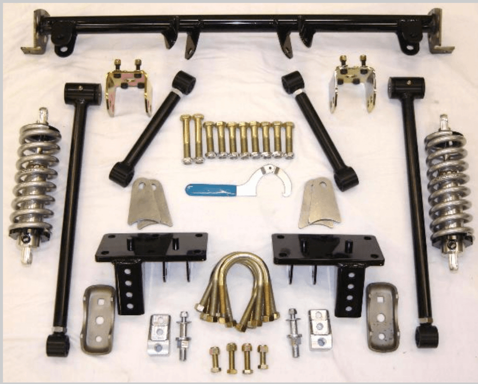

I was pretty sure I was going the route of CalTracks for improved traction and performance, and I still have some basic, simple improvements I can make to the stock suspension (shocks, loosen/remove the front sway bar, etc). The CalTracks, HD spring perches, and US Car Tools spring relocation kit (for future track only wider slicks-for now my 315/35/17 Toyo Proxes TQ drag radials for everyday work nice) would cost about $980 with the same Viking double adjustable rear shocks. The Street Lynx kit which would also give me more clearance for wider tires and includes the same shocks is double that price. I am inclined to go with the Street Lynx as they seem to be significantly better, and I only want to mod the rear once. I understand that the CalTracks are sufficient for many who go faster than I ever expect to, but if I do something for the rear suspension, I have no problem going with a much "better" system given the difference in cost.

Weekend bump...thanks for all of the replies. Anyone actually using the RMS Street Lynx system??

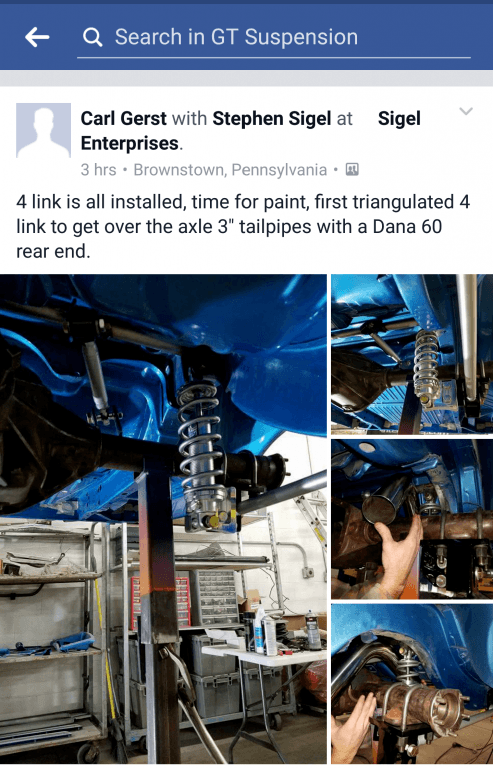

Some pictures from today.
That's really cool! I currently have 3" exhaust system with a X pipe...I usually open my Doug's electronic cutouts at the track and often for Crusin the Coast, and I like my stock style chrome tips. It would be nice if I could have 3" out the back exhaust AND a 4 link.

With Dana S60 the exhaust over axle is a No Go.
