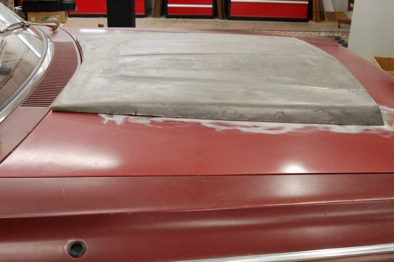

I bought a steel scoop for my '65 street wedge car. I like the way the steel scoop looks and it screws on rather than messing around with glass.

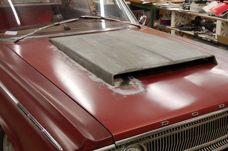

I'm not sure how the scoop is made, I assume the fabricator used some bucks or templates and hammered it into shape. It is some very impressive metal working. I've had several fabricators look at the scoop and they just shake their heads imagining how much time it would take to hammer some sheet metal into that shape. It fits the hood very well.

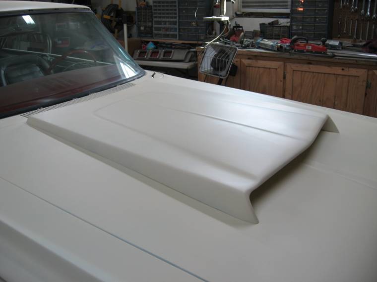

Bought this fiberglass scoop for my '64 Polara Street Wedge on E-bay. Bolts on, fit was good but with just a little work now fits perfectly and it was VERY reasonably priced.
