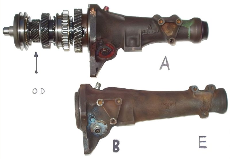

If you look at the power flow and the size of the gears 1,2,3rd should take as much as a stock A-833 but I would not power shift into OD that would be the weakest gear on the output .
This question gets asked and guys are running them behind big blocks. The gears splits are large so i done think most would consider it for a performance transmission. More of a cruising, poor man's OD trans. Dodge didn't use a steel bushing for the countershaft in the aluminum case. With use and abuse the countershaft oblongs the case hole. This could give you problems in time. Forth gear size is small as seen above. The input bearing retainer is larger at 5.25, you could turn it down or buy a new one from Brewers, so that the trans fit in you bellhousing.
