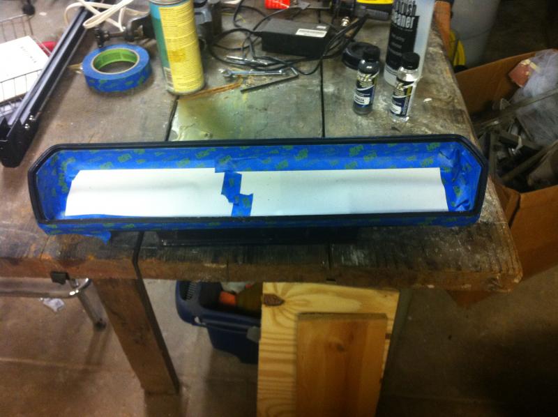

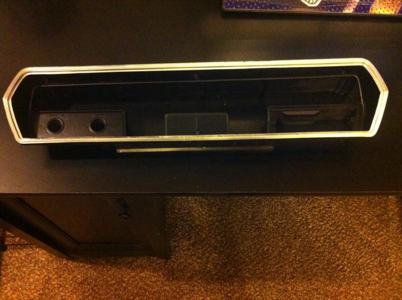

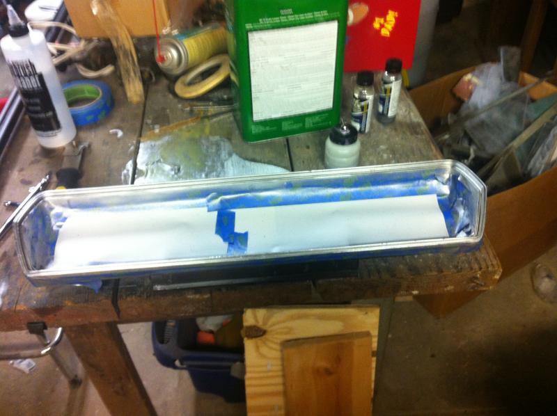

So, I got the Spaz Stix mirror chrome and once I figured out how to use the airbrush stuff again, I tried it out on an extra 66 dash I has around. You can sort of see in the pictures below what the piece looks like, it was a little rough to begin with but OK for a test. I cleaned it up, sprayed a little PRE-clean in it and gave it a heavy coat of the mirror chrome. I tried to 'polish' it a bit after it dried, but didn't see much gain. I'd have to say it looks a little better than any of the rattle can varieties I have looked at before, but it is still more silver than chrome. The black background in the last pic gives it a favorable light. To be fair this wasn't the shiniest piece of smooth black plastic to begin with, but it was a black plastic background nonetheless. I think it will suffice for a driver. I just need to figure out how to highlight the lettering and the small circles. Fortunately the 67 doesn't have the middle Plymouth emblem.

That turned out pretty good. Like you say for a driver, I wouldn't be complaining. Thanks for the how to.
