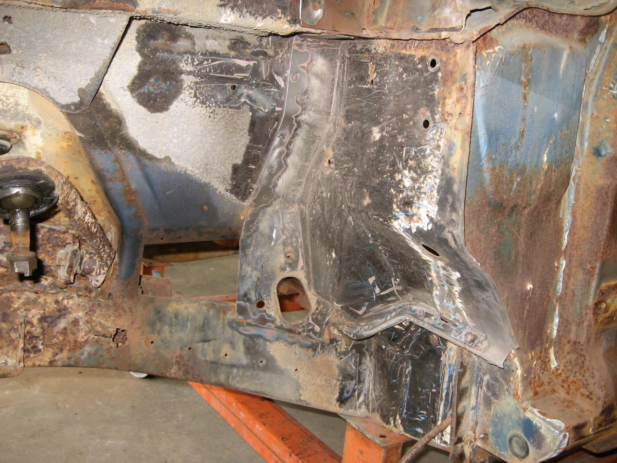

Don't bother with media blast, it has a hard time getting the soft undercoating sprayed on. I took all mine off with a propane torch and a metal putty knife. It actually comes off pretty easy once the metal is heated off. It can be tedious, but heat, then scrape, heat then scrape, repeat until you get down to metal.
Eastwood has a "softener" for easier removal, but I have not tried it yet.
Here is a picture... The right fender liner is clean, the inner still has the undercoating.
