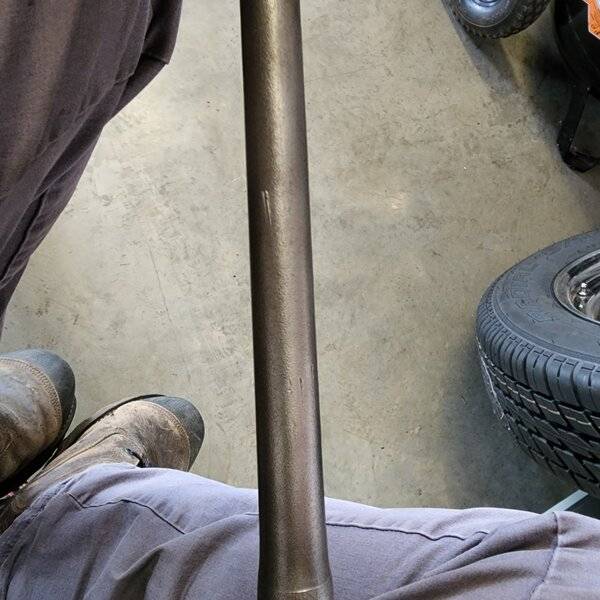

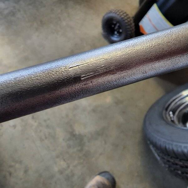

After cleaning my strut rods for a coat of black paint, noticed there are tooth marks, on one of them. I know this is bad on torsion bars due to they are made of spring steel, but does it matter on strut rods?
No, but you could file and buff it out before paint. Someone used vicegrips to hold it while tightening the nut holding it to the LCA.

Thanks, that is what I thought, but just wanted to check.
Sand and then use a needle gun before you dip them.
