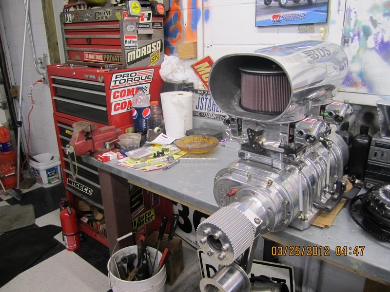

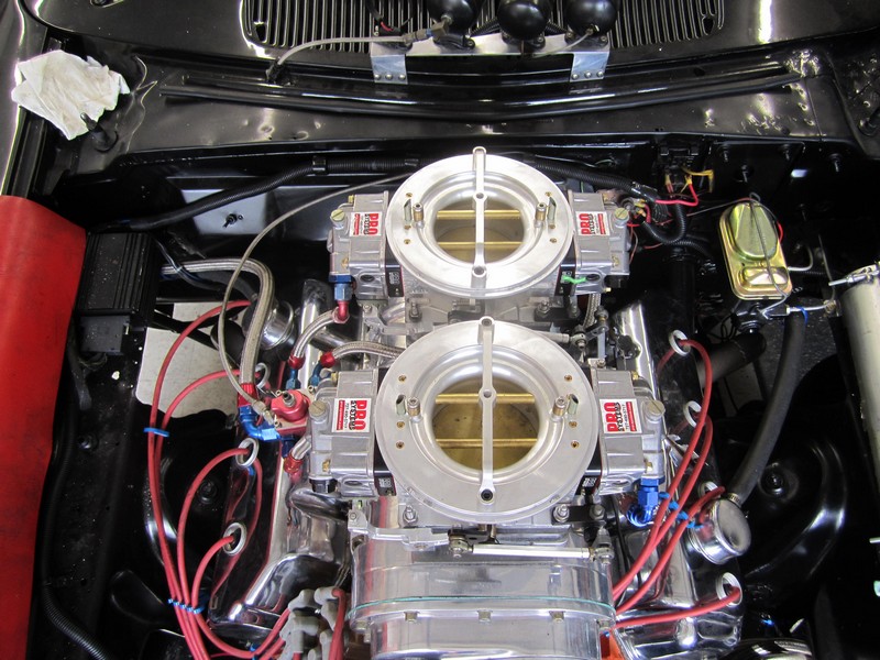

I am not a fan of running with no air cleaner,even before using my currant SV1 carbs.With a good high flow filter,there's not much of a difference with or without it on.Also helps to retain flame:icon_hang:

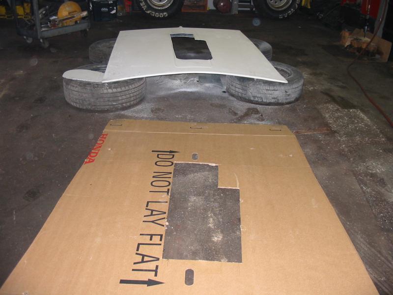

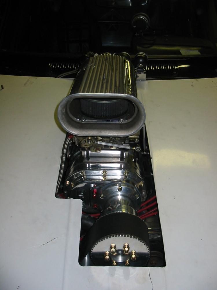

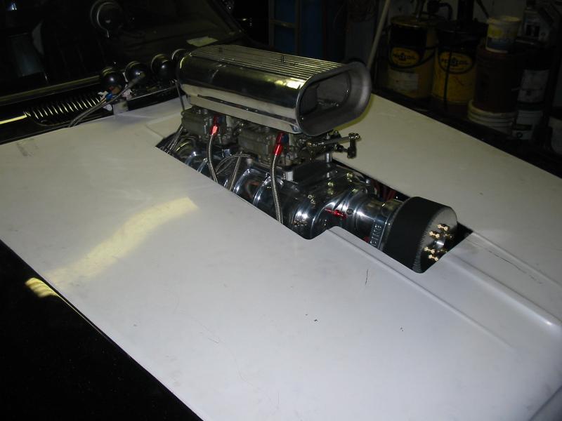

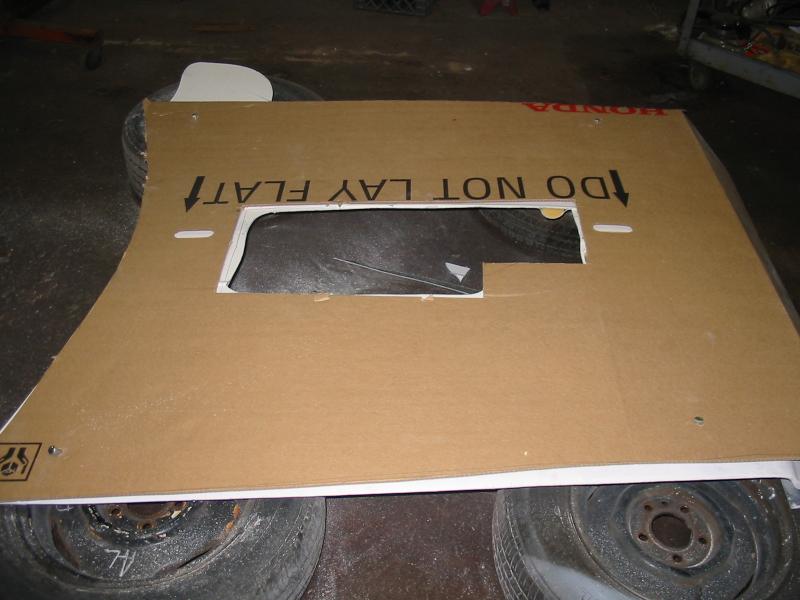

Remember,,,,,measure twice,cut once:blob1:
