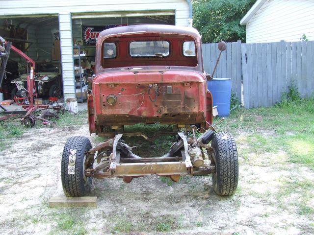

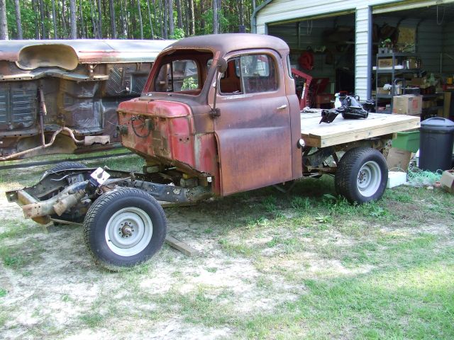

Do you have any photos of the Rat Truck project so far ??
You must be sykick or sumffin. I was out there today and it hit me I was blabberin about my rat truck with no evidence. Here it is in all it's ratty glory. I madt the bed myself and I am NO carpenter. That's probably a good thing with a rat rod.
